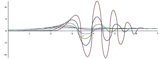

Edit: Einar Rødland has presented some graphical evidence to suggest that for fixed $t>0$, $u(t,\cdot)$ is "well-behaved" and defines a tempered distribution. I am seeking a proof of disproof of this conjecture. Note that a "wild solution" can be "well-behaved" for $t>0$ fixed. For example, in this paper, the authors present an example of nonuniqueness for the Cauchy problem which is continuous on $\mathbb{R}\times [0,\infty)$ and satisfies

  • I'm not very familiar with the field, and with tempered distributions in particular, so I may be missing something. However, for $t>0$, it seems to me $u(t,x)\rightarrow 1$ as $|x|\rightarrow\infty$, otherwise $u(t,x)$ is perfectly smooth in $x$, So it should form a tempered distribution, shouldn't it? – Einar Rødland May 18 '15 at 15:45
  • @EinarRødland: I don't follow your argument. For $t>0$, $u(t,x)$ is smooth in $x$. This follows from the uniform convergence on compact sets of the partial sums defining $u(t,\cdot)$. – Matt Rosenzweig May 18 '15 at 18:18
  • As I warned, I'm not well versed in this topic, but as I understand if $u(t,x)$ is smooth in $x$ and doesn't grow too fast as $x$ increases, it gives a tempered distribution. In this case, $u(t,x)$ doesn't grow at all: i.e., there is a bound $|u(t,x)|<C_t$ for each $t>0$. By the way, I'm not claiming to have a proof of this...it's just an experimental observation. – Einar Rødland May 18 '15 at 18:53
  • @EinarRødland: You are correct in that if $u(t,x)$ and all its partial space derivatives grow at most polynomially, $u(t,x)$ defines a tempered distribution. But I don't see how you are getting the bound $\left|u(t,x)\right|<C_{t}$; would you please give a proof of this? It was my understanding that $u$ grows quite large as $\left|x\right|\rightarrow\infty$. – Matt Rosenzweig May 18 '15 at 18:59
  • Correct me if I'm wrong, but as I understand bounded partial derivatives defines Schwartz functions $\mathcal{S}$, while the tempered distributions are their dual space $\mathcal{S}'$, where a continuous function that grows at most polynomially will yield a tempered distribution. The observation that $u(t,x)$ is bounded for each $t$ is simply based on plotting the function for some $t$ and limited ranges of $x$. – Einar Rødland May 18 '15 at 19:55
  • @EinarRødland: A Schwartz function and all its partial derivatives decay faster than any polynomial. You are correct that any continuous function with polynomial growth is a tempered distribution. I confused that with a sufficient condition for a product with a Schwartz function to be Schwartz. Your observation doesn't square with comments I have read about $u(t,x)$. Maybe you are right that for some $t>0$, $u(t,x)$ is a tempered distribution. In any case, $C_{t}$ blows up as $t\rightarrow 0$. – Matt Rosenzweig May 18 '15 at 20:14
  • The bound on $u(t,x)$ referred to there should be global, i.e. for all $t$. As you note, as $t\rightarrow 0^+$, the bounds blow up, but for each $t$ they can be met. I've tried to expand a little on this in the answer. Not sure how to prove my claims formally, however. – Einar Rødland May 20 '15 at 07:34
Here's a summary of, and extending remarks and explanations to, the comments. Note that my description of $u(t,x)$ is based on experimental observations, not formal proofs.
I plotted the sum for $u(t,x)$ for a few values of $t$: within a moderate range for $x$, it would converge, although I did need extended accuracy (used Maple for this). My understanding is largely based on what these plots looked like.
Basically, for $t\le0$ we have $u(t,x)=0$. But then, for $t>0$, the $u(t,x)$ looks like a wave packet moving in from infinity towards the origin. For a given $t>0$, beyond the region containing the wave packet, the function levels off quickly to $1$ as $x$ increases. As $t$ increases, this wave moves towards the origin and dampens out, with $u$ eventually converging to constant $1$.
However, if we move back in time towards $t=0^+$, the wave pattern is more violent, spread out, and further away from the origin: i.e., higher amplitude and wave spreads further out to higher values of $x$. As we lower $t$ towards 0, and the wave packet is further away from the origin, $u(t,x)$ converges towards $0$ for any fixed $x$.
Here's a plot showing $y=u/[(1+u^2)/2]^{1/4}$ (had to compress the scale to enable large and small amplitudes to show), for $t=1$, $1/2$, $1/3$, $1/4$, $1/5$, $1/6$, and $1/7$, with $t=1$ having the smoothest curve and $t=1/7$ the most variable. Plot of u (transformed to reduce extrema) for t=1/1,...,1/7.
Thus, for any given $t>0$, we have a nice solution with no exotic behaviour. Moreover, for $t\le0$, we have $u(t,x)=0$ which means the solution for $t>0$ does not arise from prior conditions. The extreme behaviour is only apparent as $t\rightarrow 0^+$. Thus, for any given $t>0$ the solution is a tempered distribution (and should also be a Schwartz function), but $u(t,x)$ is wildly unbounded as $t\rightarrow 0^+$.
