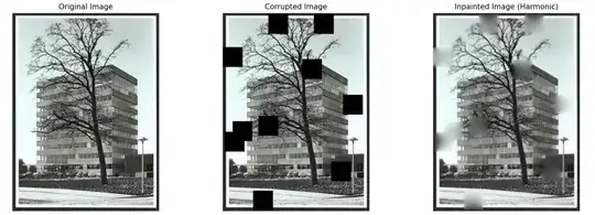

Im currently working on an implementation of the laplace dirichlet problem for the purpose of image inpainting (see image below). My implementation works fine but I now need to give an explanation as to why.
The code basically follows the flow of the heat equation $\frac{\partial u}{\partial t} = \Delta u$ on the corrupted part until the time step is $\approx0$. Obviously this outcome is then (approximately) a stationary point to the laplace dirichlet problem.
