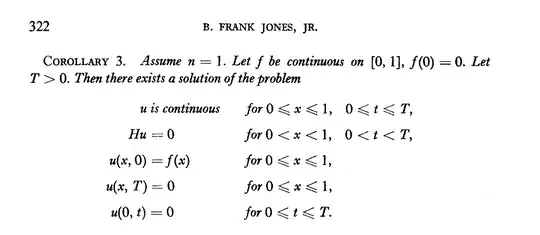

You may find the following article of interest.
B.Frank Jones, A fundamental solution for the heat equation which is supported in a strip, Journal of Mathematical Analysis and Applications, Volume 60, Issue 2, 1977, Pages 314-324, ISSN 0022-247X, https://doi.org/10.1016/0022-247X(77)90021-X.
In particular see Corollary 3 therein. The behavior at the origin is somewhat similar to what you seek. (Note however that it deals with the forward heat equation. You might ask yourself if the methods can be adapted to the backwards heat equation). enter image description here
BTW Your usage of the phrase boundary condition is a bit confusing since I assume you are working on the entire real line, which has no boundary. Off hand I wouldn't know what would be a better phrase however.
