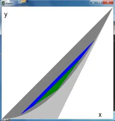

All of the questions and answers are related to the Moment problem . The functions considered have compact support (hope this terminology is correct). More specifically, the above Q & A list is related to the Hausdorff moment problem ; without loss of generality, the bounded interval is taken as $[0,1]$ . As pointed out in the Wikipedia reference, the following integral sheds more light on properties of the moments. Let $f(x)$ be real, integrable and positive with area $\,m_0 = 1\,$ equal to one - in short: $f(x)$ resembles a Probability Density Function (PDF) - then: $$ \int_0^1 f(x) x^n (1-x)^k dx > 0 \quad \Longrightarrow \quad \left\{ \begin{array}{l} m_0 > 0 \; , \; m_1 > 0 \; , \; m_2 > 0 \\ m_0 > m_1 \; , \; m_2 > m_1 \\ m_0 - 2 m_1 + m_2 > 0 \end{array}\right. $$ Attention will be restricted to the first few moments : $m_1,m_2$ . If we put $\;x = m_1/m_0=m_1\;$ and $\;y = m_2/m_0=m_2\;$ then it follows that all $(x,y)$ values are within the $\color{silver}{silver}$ triangle with vertices $(0,0),(0,1/2),(1,1)$ , as shown in the picture at the bottom. $$ y > 0 \quad ; \quad y < x \quad ; \quad y > 2 x - 1 $$ Schwarz' inequality gives rise to a somewhat more restrictive condition: all $(x,y)$ values are within the $\color{gray}{gray}$ area between a parabola and a straight line: $$ y < x \quad ; \quad y > x^2 $$ This is as far as I have been able to go with general considerations about moments. But if someone knows better, I'm eager to learn about it.

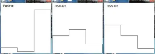

  • histograms consisting of three blocks with the same width
Please read the reference, because the argumentation shall not repeated here.
The three moments $\,m_0,m_1,m_2\,$ are linear in the three function values $f_0,f_1,f_2$ and vice versa. Meaning that there is a one-to-one mapping between function space and moment space $\,(x=m_1/m_0,y=m_2/m_0)\,$ where $m_0 = 1$ . The moment space of 3-histograms is in the picture below. If the only requirement is that the histogram is just positive (and with area $= 1$) then what we have is the $\color{blue}{blue\; triangle}$. If an additional requirement is that the histogram is concave then we have the $\color{green}{green\; triangle}$ as a proper part of the blue one. Let's formulate this as follows.
Consider the universe of all PDF 3-histograms, what then is the chance that such a histogram is concave ? The answer must be the quotient of the areas of the green and the blue triangle. With the above reference that is: $\,(4/243) / (1/27) = 4/9$ . With other words: $\large 4/9$ of all histograms in our special universe are concave.

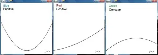

Consider the universe of all PDF-like parabolic functions at the interval $t \in [0,1]$ : $$ p(t) = a_0 + a_1 t + a_2 t^2 $$ The following Q & A has been helpful with visualization of the parabolas:
There is a linear relationship between the coefficients of the parabola and the first few moments, via the Hilbert matrix and its inverse: $$ \left[ \begin{array}{c} m_0 \\ m_1 \\ m_2 \end{array} \right] = \left[ \begin{array}{ccc} 1 & 1/2 & 1/3 \\ 1/2 & 1/3 & 1/4 \\ 1/3 & 1/4 & 1/5 \end{array} \right] \left[ \begin{array}{c} a_0 \\ a_1 \\ a_2 \end{array} \right] \quad \Longleftrightarrow \quad \left[ \begin{array}{c} a_0 \\ a_1 \\ a_2 \end{array} \right] = \left[ \begin{array}{ccc} 9 & -36 & 30 \\ -36 & 192 & -180 \\ 30 & -180 & 180 \end{array} \right] \left[ \begin{array}{c} m_0 \\ m_1 \\ m_2 \end{array} \right] $$ As usual, we define the coordinates in moment space as $\,x=m_1/m_0\,$ and $\,y=m_2/m_0\,$ with the area normed to one $\,m_0=1$ . Let's start with demanding that the parabolas are positive at $[0,1]$ . Which is e.g. the case if the discriminant is negative together with a positive leading coefficient: $$\color{blue}{ \left. \begin{array}{l} a_1^2 - 4 a_2 a_0 < 0 \\ a_2 > 0 \end{array} \right\} \quad \Longleftrightarrow \quad \left\{ \begin{array}{l} 152 x^2 - 300 x y + 150 y^2 - 42 x + 40 y + 3 < 0 \\ y - x + 1/6 > 0 \end{array} \right. } $$ Note that what's up here is exactly (the inside of) the ellipse that was questioned about in:
with the line $y - x + 1/6 = 0$ tangent to it in $B=(1/2,1/3)$ .
This question and its answers are a prerequisite for understanding what follows.
Another way for the parabola to be positive is that $\;p(0) > 0\;$ and $\;p'(0) > 0\;$ , or $\;p(1) > 0\;$ and $\;p'(1) < 0\;$ , again with positive $a_2$ : $$ \color{red}{ \left. \begin{array}{l} a_0 > 0 \\ a_1 > 0 \\ a_2 > 0 \end{array} \right\} \quad \Longleftrightarrow \quad \left\{ \begin{array}{l} y - 6/5 x + 3/10 > 0 \\ y - 16/15 x + 1/5 < 0 \\ y - x + 1/6 > 0 \end{array} \right. } $$ $$ \color{red}{ \left. \begin{array}{l} a_0+a_1+a_2 > 0 \\ 2a_2+a_1 < 0 \\ a_2 > 0 \end{array} \right\} \quad \Longleftrightarrow \quad \left\{ \begin{array}{l} y - 4/5 x + 1/10 > 0 \\ y - 14/15 x + 2/15 < 0 \\ y - x + 1/6 > 0 \end{array} \right. } $$ At last we have the possibility that the parabola is concave and positive: $$ \color{green}{ \left. \begin{array}{l} a_0 > 0 \\ a_0+a_1+a_2 > 0 \\ a_2 < 0 \end{array} \right\} \quad \Longleftrightarrow \quad \left\{ \begin{array}{l} y - 6/5 x + 3/10 > 0 \\ y - 4/5 x + 1/10 > 0 \\ y - x + 1/6 < 0 \end{array} \right. } $$ Working out the data results in the "ellipse with a hat" geometry as has been presented before.
Now we are ready to answer the question: what is the probability that a parabolic PDF at $[0,1]$ is concave ? The answer is the area of the $\color{green}{green}$ triangle in the picture below divided by the area of the ellipse-with-a-hat as a whole (i.e. $\color{blue}{blue} + \color{red}{red} + \color{green}{green}$ ). And the end result is: $$ \frac{1/180}{\pi\sqrt{3}/180(1-1/3)+1/120+2/720+1/180} = \frac{1}{2\pi/\sqrt{3}+3} \approx 15 \% $$
