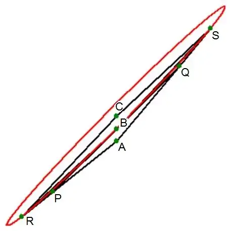

$$ A = (1/2,3/10) \quad ; \quad B = (1/2,1/3) \quad ; \quad C = (1/2,11/30) \\ P = (1/3,1/6) \quad ; \quad Q = (2/3,1/2) \\ R = (1/4,1/10) \quad ; \quad S = (3/4,3/5) $$ Triangle edges are black; ellipse is $\color{red}{red}$ .
Triangle areas: $\Delta PAQ = 1/180$ , $\Delta PRB = \Delta QSB = 1/720$ .
It is conjectured that the ellipse sector area $\overline{CRBSC}$ is exactly $1/3$ of the total ellipse area;
the latter being $ = \pi\sqrt{3}/180$ . Can someone prove or disprove this conjecture?

  • Thanks, Lucian: I can calculate now the area of the desired sector. With the surprising result that it seems to be exactly $1/3$ of the total area of the ellipse ! Can't figure out why .. – Han de Bruijn Dec 02 '14 at 17:36
The integral is elementary. $$ I = \int \frac{d \theta} {a \cos^2(\theta) - b \cos(\theta) \sin(\theta) + c \sin^2(\theta)}= \int \frac{d \tan(\theta)} {a - b \tan(\theta) + c \tan^2(\theta)} $$ Let $u=\tan(\theta)$ , then: $$ I = \int \frac{d u}{c u^2 - b u + a} = \int \frac{d u/c}{\left[ u-b/(2c) \right]^2+a/c - \left[b/(2c)\right]^2}=\\ 2 \int \frac{d (2c u-b)}{(2c u-b)^2+(4ac-b^2)}= \frac{2}{\sqrt{4ac-b^2}} \int \frac{d\left[(2c u-b)/ \sqrt{4ac-b^2}\right]} {1+\left[(2c u-b)/\sqrt{4ac-b^2}\right]^2} $$ Now let $\Delta = \sqrt{4ac-b^2}$ and we're finished: $$ I(\;\tan(\theta)\;) = \frac{2}{\Delta} \arctan\left(\frac{2c\tan(\theta)-b}{\Delta}\right) $$ Fill in the numbers for our sector: $a = 152\;,\;b = 300\;,\;c = 150$ , $\tan(\theta_2) = 16/15\;,\;\tan(\theta_1) = 14/15$ ; remember that an $\arctan$ is only defined for arguments $\in \left[-\pi/2,+\pi/2\right]$ and that the whole area of the ellipse equals $\pi\sqrt{3}/180$ . Then: $$ \mbox{area} = \frac{\pi\sqrt{3}}{180}/2 - \left[\;I(16/15)-I(14/15)\;\right]/12 = \frac{\pi\sqrt{3}}{540} $$ Thus establishing that the AfterMath conjecture is true. So finally we have all the ingredients to calculate the area of the "ellipse with a hat" ( $\color{blue}{blue} + \color{red}{red} + \color{green}{green}$ ) : $$ \color{blue}{\pi\sqrt{3}/180(1-1/3)+1/120}+\color{red}{2/720}+\color{green}{1/180} = \frac{\pi\sqrt{3}}{270}+\frac{1}{60} $$ enter image description here
