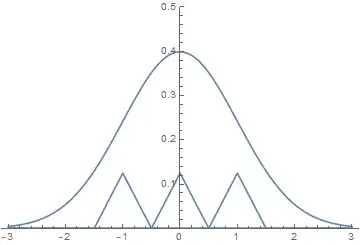

To see this, find three adjacent triangles below the graph of $f$, e.g.:
normal with triangles
More formally, by the continuity of $f$, choose $b,u,v$ such that $f(x)>v>0$ for $x$ in $[b-3u,b+3u]$. Let \begin{align} f_1 &= v \max(0, 1-|x-b+2u|/u)\\ f_2 &= v \max(0, 1-|x-b+0u|/u)\\ f_3 &= v \max(0, 1-|x-b-2u|/u)\\ f_4 &= f-f_1-f_2-f_3\\ \end{align}
The picture above shows $f_1,f_2,f_3$ under a standard normal $f$, with $b=0,$ $u=1/2,$ $v=1/8.$

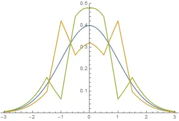

Now choose $\epsilon$ such that $w_4=1\pm\epsilon$ both yield positive values of $w_1, w_2, w_3$. Let $g$ be the value of $\sum w_i f_i$ corresponding to $w_4 = 1+\epsilon$, and let $h$ be the value corresponding to $w_4 = 1-\epsilon$. Then $f$ is an even mixture of $g$ and $h$.
In the example above, choosing $\epsilon=1/4$ gives $f,g,h$ as in the blue, green and orange of the graph below, and all are in $S(0,1)$.
normal as mixture
