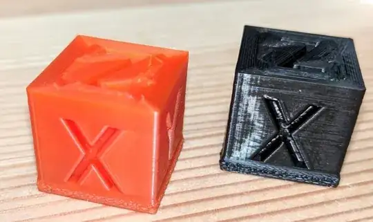

What happens is that the first ~3 mm of the print comes out "sloppy". After that, everything clears up and it prints fine for the rest of the print. (Although it perhaps looks a little under extruded on the top layer)
It looks almost like it's over extruding. But if that's the case, why would it only be for the first 3 mm? Then the top layer looking under extruded makes that possibility even more unlikely.

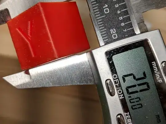

Measuring the calibration cube
I suspect what was happening is that the rollers were too loose and at certain heights they we allowing movement in the Z axis. Perhaps there is a flat spot that was allowing the X rail to droop, then once it got past the flat spot it would print cleanly again.
I haven't printed anything tall enough yet to see if the bad layers still show up higher in the print, if they do, I think it is probably a sign that I need to replace some rollers. In the mean time, I'm thrilled to be getting decent prints again!
