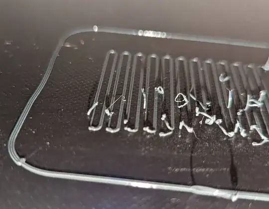

  • Summary: On the first layer, every time the printer starts extruding to the bed after a move, the first approx. 10 mm doesn't stick, but the rest sticks perfectly.
The issue, as an example, I'm trying to print a case for a Raspberry Pi which has air vents on the bottom. When the print starts, it does the line down the side which the first ~ 10 mm doesn't stick, but the rest does perfectly. It prints the skirt, which again the first ~ 10 mm doesn't stick, but the rest does, then when it gets to doing the vent slots, the same again.
The photo hopefully shows what I'm trying to explain.
Initial extrude not sticking

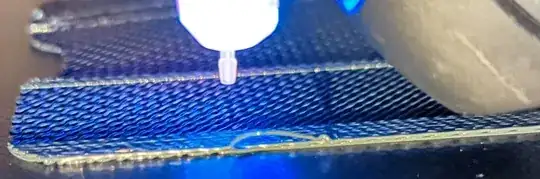

When printing a raft, again the first ~ 10 mm of the extrude doesn't stick, but the remaining does.
Raft initial extrude does not stick but the rest does

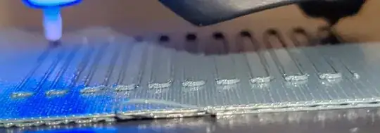

Once the raft is printed, the first layer sticks to it perfectly well
First layer sticks to raft without problem
The bed is pretty level, I'm using a BLTouch to assist and has been cleaned with alcohol before the print. Bed has been levelled and the Z-offset calibrated to -2.97.
I have Enable Retraction on, 5 mm, 45 mm/s speed. I've tried increasing and reducing these, increasing/decreasing print speed, manual Z-axis offset fine adjustments, etc.
I did think First 3 mm prints poorly, then fine after that was kind of the same issue, but there's no discussion of the issue being for every touch of the bed within the same print job.
Any advice would be appreciated. I've loitered this community for quite a while and lots of Google searching hasn't come up with any suggestions (there's actually very little I could find on this kind of troubleshooting).
Aubs
  • 133
From the pictures it looks like the distance between your bed and nozzle is too great. The way I see this is that the extrusion lines that should be pressed against each other have small gaps between them, and look rounded rather than flat. The only other way this could happen is with severe underextrusion/wrong esteps-per-mm, but that seems unlikely.
Note that "automatic bed leveling" fundamentally cannot help you get this right because it depends on a quantity it can't measure, the Z offset between the bed leveling probe and the nozzle tip. At best it can help you get the distance consistent[ly wrong].
This is also consistent with raft fixing the problem, since the raft has extra wide extrusions in the first layer whose width will just vary if the leveling is wrong, and after that, all print heights are just relative to the top of the raft.
