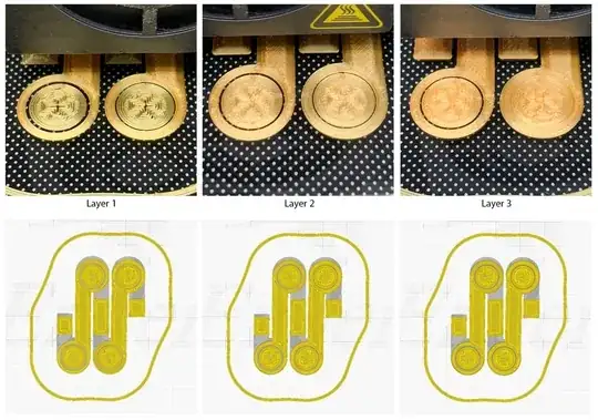

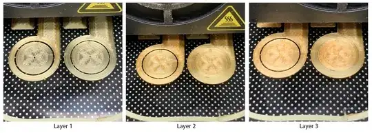

Here's an example where I've tried to print some hinges:
First three layers
It's a test print where each hinge has a different tolerance, so the left and right are expected to look different. Below each real image is a preview layer from Cura showing how it's supposed to look.
The first layer appears OK. The second layer looks a little messy, and the gap between inner and outer circles has shrunk. By the third layer the hinge on the right is completely fused.

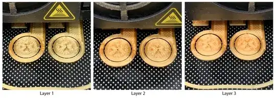

At R.. GitHub STOP HELPING ICE's suggestion I returned the e-steps to default (93), re-leveled the bed, and adjusted the z-offset tighter. I made 10 attempts with varying z-offsets, and here's the best one:
First three layers with e-steps at 93
The first layer looks better! But the second and third layers are just as bad as before, in fact maybe worse. The circle on the right completely fused on only the second layer. And the top surface is just as ripple-ey and messed up as before.

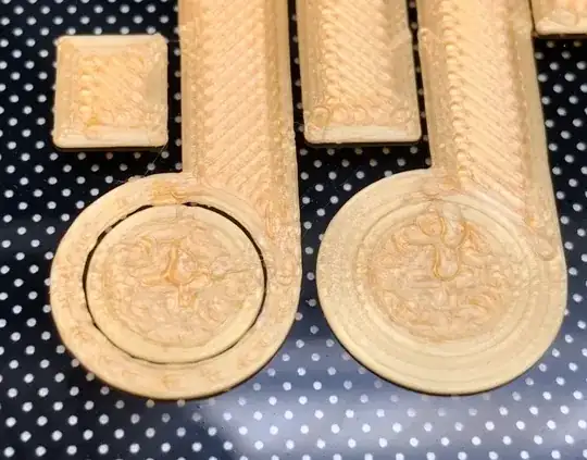

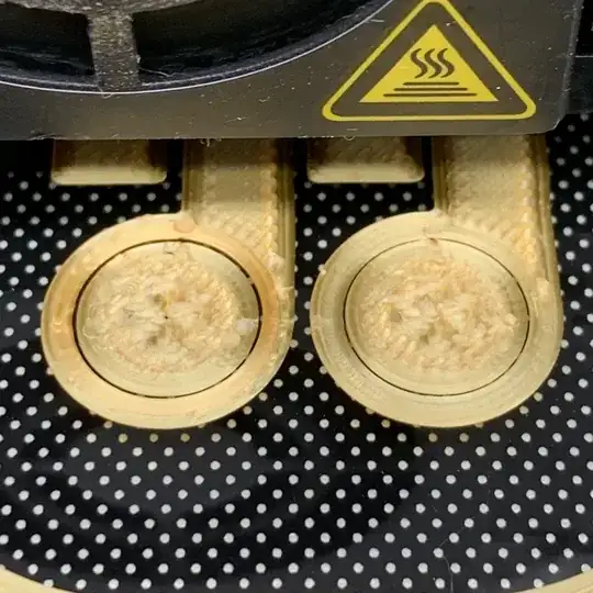

Here's a closeup of the fourth layer to show how bad it is: Fourth layer
So although the re-calibrated e-steps may have been a problem, that clearly wasn't the only problem. What else should I be looking at here?

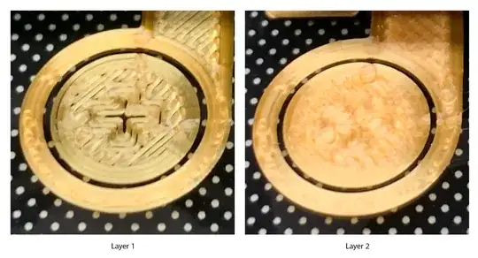

At 0scar♦s suggestion I tried a print with 0.2 mm layer height. Here's the first layer: 0.2 mm layer height, first layer Looks like the same over-extrusion.
Then I tried reducing the flow multiplier to 90% (for both "flow" and "initial layer flow") and printing at 0.2 mm layer height: 90% flow with 0.2 mm layer height Better, but it still looks over-extruded!

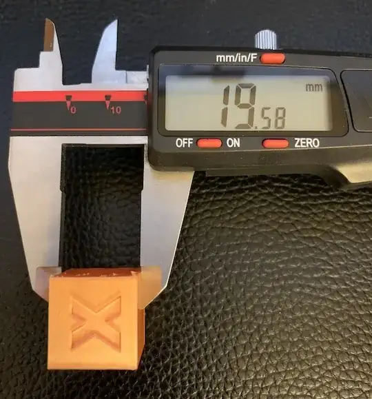

I checked by leveling the bed and zeroing the Z axis at 0.05 mm above the bed, using a feeler gauge. I gave it the instruction to move the Z axis up by 0.2 mm (to simulate a single layer), then checked it with a 0.25 mm feeler gauge. It did not fit. I raised it .01 mm at a time, and I was not able to insert the gauge until it hit 0.5 mm!
I printed a 20 mm test cube and measured the Z height: Initial 20 mm test cube
At 19.58 mm, it was short. Only a little bit though, which is consistent with Z problems only occurring in the first few layers for some reason.

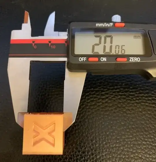

Revised 20 mm test cube
OK, at 20.06 mm it's not perfect, but it's a lot better. I printed the hinges again:
Hinges
Again not perfect, but so much better. And the specific problem of uncontrollable expansion in the 2nd and 3rd layers is totally gone.

OK, let's start with your pictures. Putting aside the expansion in the XY plane, layer 1 looks seriously underextruded (gaps between the lines, even) while layers 2 and 3 look severely overextruded. It would be possible to achieve this with a reduced first-layer flow setting, but you haven't indicated that, and moreover, in addition to looking underextruded, the first layer's lines don't look very flat - they look a lot thicker than 0.12 mm. I suspect if you can take a caliper with resolution greater than 0.1 mm and measure the thickness of the first layer, you'll find it's at least 0.2 mm thick, maybe more.
So, what's happening? You're overextruding by a lot, but have lowered your bed enough to (more than) compensate, giving the excess material in the first layer a whole 0.2 mm or more of vertical space to expand into, preventing it from being pressed against the bed and taking up the horizontal space it should. Now, as soon as you start the next layer, the big problems start. Since the nozzle has only moved up by 0.12 mm, you only have 0.12 mm of vertical space, and the overextruded material gets squeezed out horizontally. Some of it goes down into the gaps between the lines of the first layer. But by the time you get to layer 3, there are no gaps and things go really bad.

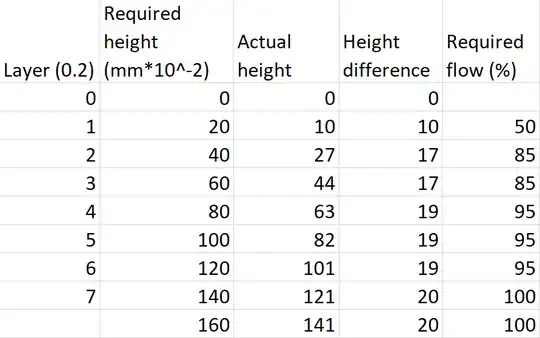

There is a problem with Z-axis' uneven movement. I worked a lot on fixing this and the solution I came up with was to reduce flow in Cura post-processing. You need to measure the movement of the X-axis in the vertical direction on the first layers and calibrate flow. Hope this helps as it helped me.
Spreadsheet of Ender 3 first layers height
