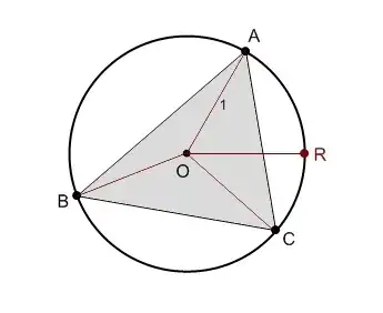

Given a circle with radius R = 1, I'm trying to find either the probability distribution function or the density function for the space of triangle, which is randomly selected on this circle. The same task is for perimeter function of this triangle.
The only thing I've understood is the following. If we fix some point R on the circle, then angles ROA, ROB, ROC (counterclockwise) are uniformly distributed on [0; 2 * Pi]. I've tried expressing the space and the perimeter through those angles, but still had no success.

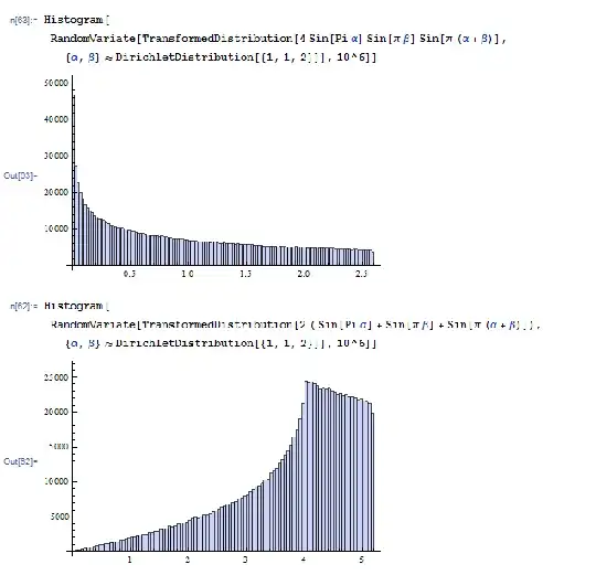

The area of the triangle, is then $$ A = 4 \sin \left( \frac{\phi_2-\phi_1}{2} \right) \sin \left( \frac{\phi_3-\phi_2}{2} \right) \sin \left( \frac{\phi_3-\phi_1}{2} \right) $$ and the perimeter $$ p = 2 \left( \sin \left( \frac{\phi_2-\phi_1}{2} \right) + \sin \left( \frac{\phi_3-\phi_2}{2} \right) + \sin \left( \frac{\phi_3-\phi_1}{2} \right) \right) $$ Given that $\frac{\phi_3 -\phi_1}{2} = \frac{\phi_3 -\phi_2}{2} + \frac{\phi_2 -\phi_1}{2}$, let $\alpha = \frac{\phi_2-\phi_1}{2}$ and $\beta = \frac{\phi_3-\phi_2}{2}$, then $$ A(\alpha, \beta) = 4 \sin \alpha \sin \beta \sin (\alpha+\beta) \qquad p(\alpha, \beta) = 2 \left( \sin \alpha + \sin \beta + \sin (\alpha+\beta) \right) $$ The distribution of $\alpha$ and $\beta$ are not hard to find. Indeed, distribution of $\phi_1$, $\phi_2$ and $\phi_3$ ($[\chi]$ stands for Iverson bracket): $$ \mathrm{d} F(\phi_1, \phi_2, \phi_3) = \frac{3!}{(2 \pi)^3} \Big[ 0 < \phi_1 < \phi_2 < \phi_3 < 2 \pi \Big] \mathrm{d} \phi_1 \mathrm{d} \phi_2 \mathrm{d} \phi_3 $$ Changing variables to $\alpha = \frac{\phi_2-\phi_1}{2}$, $\beta=\frac{\phi_3-\phi_2}{2}$ and $\gamma = \frac{1}{3} \left( \phi_1 + \phi_2 + \phi_3 \right)$ we get, noting that the Jacobian equals $4$, $$ \mathrm{d} F(\alpha, \beta, \gamma) = \frac{3!}{(2 \pi)^3} \Big[ 0 < \alpha < \pi, 0 < \beta < \pi-\alpha, \frac{4 \alpha + 2 \beta}{3} <\gamma< 2\pi - \frac{2 \alpha + 4 \beta}{3} \Big] \cdot 4 \cdot \mathrm{d} \alpha \, \mathrm{d} \beta \, \mathrm{d} \gamma $$ Integrating over $\gamma$ we find the joint pdf for $(\alpha, \beta)$: $$ \mathrm{d} F\left(\alpha,\beta\right) = \frac{3!}{\pi^3} \left( \pi - \alpha - \beta \right) \Big[ 0 < \alpha < \pi, 0< \beta < \pi - \alpha \Big] \, \, \mathrm{d} \alpha \, \mathrm{d} \beta $$ This means that $\left\{ \frac{\alpha}{\pi}, \frac{\beta}{\pi} \right\}$ follows Dirichlet distribution with parameters $\{1,1,2\}$.
Histograms for area and perimeter distribution probability densities

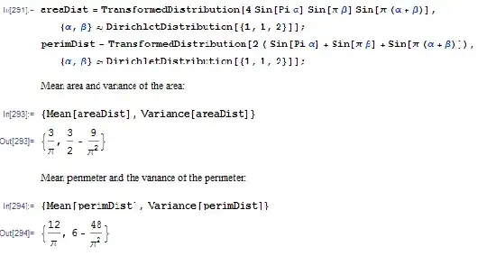

Using the interpretation in terms of the Dirichlet distribution, it is not hard to determine the mean and the variance of the area and the perimeter:

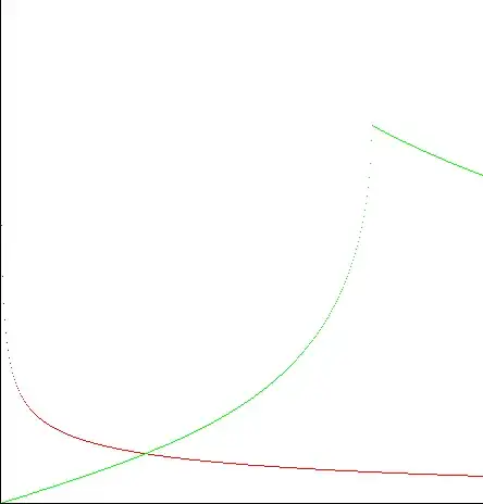

Here are numerically obtained plots of the distributions:
Red is the area, green is the perimeter; both plots are scaled such that the maximal possible value, $3\sqrt3/4$ for the area and $3\sqrt3$ for the perimeter, is at the right-hand edge. Note the singularities at area $0$ and perimeter $4$, the latter corresponding to a degenerate triangle on a diameter of the circle.
I calculated these by fixing one point and equidistantly sampling the other two points at $10,000$ values each.

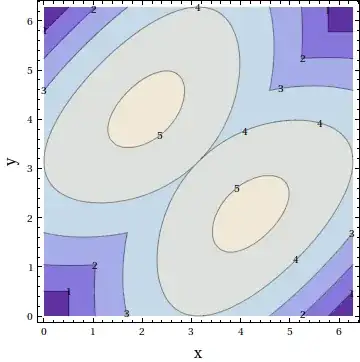

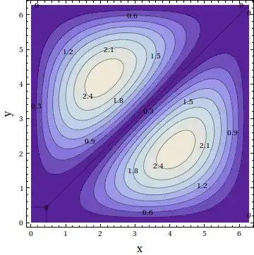

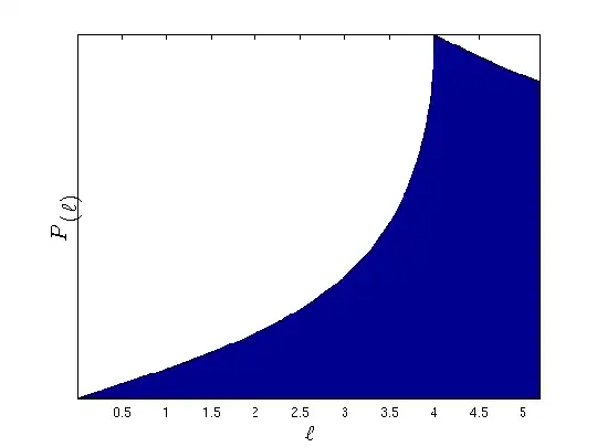

If you fix the first point to be on (0,1), the triangle is completely described by the two angles $x,y$ that I described before. Elementary geometrical calculations show that the area of this triangle is $$A(x,y)=\frac{1}{2}\left|\sin(x)-\sin(y)-\sin(x-y)\right|$$ and the perimeter is given by $$\ell(x,y)=2\left[\sin\left(\frac{x}{2}\right)+\sin\left(\frac{y}{2}\right)+\sin\left(\frac{\left|x-y\right|}{2}\right)\right]$$ Here are the contour plots of these functions. Area:
Area
Perimeter:
Perimeter
The contour curves themselves can be calculated analytically, but I couldn't integrate them to arrive at the CDF. However, you can numerically calculate the CDF/PDF from these contour plots: $P(A<a)$ is exactly the area outside the contour $A=a$, and the same can be done for $\ell$. Thus you do not need to revert to random sampling, and your problem reduces to numeric integration, which can be preformed at arbitrary precision. Here is the result for $\ell$, which is of course identical to that of joriki.

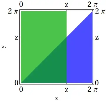

From symmetry, you know that the distributions of $\alpha,\beta,\gamma$ are the same. so let's look at the distribution of $\alpha$. The CDF is given by $ P(\alpha<z)=P(x<z \mbox{ and } y>x) + P(y<z \mbox{ and } x>y) $ Let's find that probability in graphic way, because this is always instructive. This region in the $xy$ space is drawn in the figure,
The blue region is $x<y$ and the green region is $x<z$. Since $x,y$ are uniformly distributed, the probability of this event is the area of the triangle, normalized by the total area, that is $$P(\alpha<z) = 2 \left(\frac{\frac{1}{2}z^2}{4\pi^2}\right)$$ And from now on it's straight forward (but remember that $\alpha,\beta,\gamma$ are not independent)
