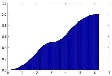

I've run simple simulation and plotted CDF. Got something like thisCDF of second larger angle

EDIT: Simulation code (in Python) for single experiment:
def experiment():
    x1 = 2*math.pi*random.random()
    x2 = 2*math.pi*random.random()
    x3 = 2*math.pi*random.random()
    angles = [x1 - x2, x2 - x3, x3 - x1]
    for i in range(len(angles)):
        if angles[i] < 0:
            angles[i] += 2*math.pi
    angles.sort()
    return angles[1]

  • Your weird behavior of the histogram might be because you're considering that $\alpha, \beta, \gamma$ form three angles. But really, the three points only form two angles, with one of the angles being a compliment. Consider instead only the angles between $\alpha$ and $\beta$, and $\alpha$ and $\gamma$ (or $\beta$ and $\gamma$), since the remaining angle is completely determined by the first two you pick. – Emily Dec 03 '13 at 17:18
  • @Arkamis hm, I've tried to do simulation by the statement: generate three angles $\in [0,2\pi)$, calculate differences between consecutive angles, add $2\pi$ if angle is less than $0$, sort angles, return middle one – Boris Dec 03 '13 at 17:25

One problem with the Python code is that given any two points on the circle, there are two possible angles between them (adding up to $2\pi$). The correct angle is determined by the position of the third point. Because of this problem, you have CDF increasing beyond $\pi$ the maximum possible value of the middle angle. Before you sort angles, you should add lines like:
if (x1-x3)*(x2-x3) < 0:
        angles[0] = 2*math.pi - angles[0]
if (x2-x1)*(x3-x1) < 0:
        angles[1] = 2*math.pi - angles[1]
if (x3-x2)*(x1-x2) < 0:
        angles[2] = 2*math.pi - angles[2]

  • Thanks. I've modified Python code to sort generated points to have complementary angles. Resulting histogram behaves exactly as your analytical CDF function. – Boris Dec 03 '13 at 20:30
