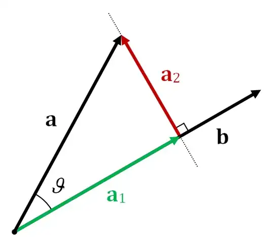

All is in this picture (from wikipedia on Vector Projection) : a1 is the projection of a on b
Vectors are not "lines" they are "segments" that have a direction. A vector is like going from one place to an other. It can gives the following answers : Where does it start, where does it end, which direction is it going and what is the length of it.
The projection would be, I'm walking on trail b (why not a sea trail) where do I stop in the direction of b to be the closest to the end of trail a (like dunno wales eating spot).
This walk you have to make to be the closest is your projection a1 enter image description here
