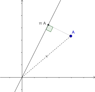

Start with simple cases: What’s the distance from a point to a line? How about to a plane? After a bit of experimentation, you might hit upon the idea that it’s the minimum distance between that fixed external point and any point on the line/plane. Simple geometric considerations show that this minimum distance is obtained when we measure it in a direction perpendicular to the line/plane, and so the nearest point to the fixed external point is the latter’s orthogonal projection onto the line/plane (labeled $\pi A$ in the diagram).
If we subtract this projection from the original point, we get a vector that’s orthogonal to the line/plane (called the orthogonal rejection from the line/plane), so the distance we’re looking for is equal to the length of this difference vector.
One can prove in various ways that this holds in general, namely, that the minimum distance from a point to an $m$-dimensional subspace lies along a direction that’s perpendicular to it. We’ll just take that as given. So, to compute this distance, you project the point onto the subspace and find the length of the difference between that projection and the original point.
