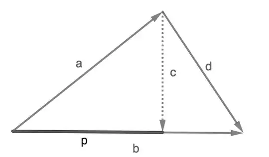

Geometric Meaning
As other answers have pointed out, the dot product $\vec{a} \cdot \vec{b}$ is related to the angle $\theta$ between $\vec{a}$ and $\vec{b}$ through:
$$\vec a \cdot \vec b = \Vert\vec a\Vert_2 \, \Vert\vec b\Vert_2 \, \cos \theta$$
Assuming that $a$ and $b$ point into similar directions, i.e., $\theta \leq 90°$, we can visualize what this relationship means (skipping the vector arrows and Euclidean norm subscript from now on):
$p$ is the vector resulting from an orthogonal projection of $a$ onto $b$. As the $\cos$ is the ratio between the adjacent leg ($p$) and the hypotenuse ($a$) in the right triangle, i.e.,
$$\cos \theta = \frac{\Vert p \Vert}{\Vert a \Vert},$$
we get for the inner product:
$$a \cdot b = \Vert a \Vert \, \Vert b \Vert \, \frac{\Vert p \Vert}{\Vert a \Vert} = \Vert p \Vert \Vert b \Vert$$
So, the inner product is the length of the vector $p$, the projection of $a$ onto $b$, multiplied by the length of $b$. If $a$ and $b$ point into opposite directions, i.e., $90° < \theta \leq 180°$, the dot product will be the negative: $a \cdot b = - \Vert p \Vert \Vert b \Vert$

Let's calculate the length of the projection $p$ using $a$ and $b$. We can start by using the Pythagorean theorem:
$$ \Vert p \Vert ^2 = \Vert a \Vert ^2 - \Vert c \Vert ^2$$
Because $a$ is a unit vector:
$$ \Vert p \Vert ^2 = 1 - \Vert c \Vert ^2$$
Now, we need to calculate the length of $c$ using the other rectangular triangle. Again, we use the fact that $b$ is a unit vector, i.e., $ \Vert b \Vert = 1$.
$$ \begin{align} \Vert c \Vert ^2 &= \Vert d \Vert ^2 - (\Vert b \Vert - \Vert p \Vert)^2 \\ &= \Vert d \Vert ^2 - (1 - \Vert p \Vert)^2 \\ &= \Vert d \Vert ^2 - 1 + 2 \Vert p \Vert - \Vert p \Vert^2 \end{align} $$
Now, we can insert this term for $\Vert c \Vert ^2$ in the equation above:
$$ \begin{align} \Vert p \Vert ^2 &= 1 - \Vert d \Vert ^2 + 1 - 2 \Vert p \Vert + \Vert p \Vert^2 \\ 0 &= 2 - \Vert d \Vert ^2 - 2 \Vert p \Vert \\ 2 \Vert p \Vert &= 2 - \Vert d \Vert ^2 \end{align} $$
In the figure, we see that $\vec a + \vec d = \vec b$. Therefore, $\vec d = \vec b - \vec a$, or:
$$d_i = b_i - a_i$$
Thus, we can express $\Vert d \Vert^2$ as:
$$ \begin{align} \Vert d \Vert ^2 &= \sum_i d_i^2 \\ &= \sum_i (b_i - a_i)^2 \\ &= \sum_i b_i^2 - 2 b_i a_i + a_i^2 \\ &= \sum_i b_i^2 - \sum_i 2 b_i a_i + \sum_i a_i^2 \\ &= \Vert b \Vert^2 - \sum_i 2 b_i a_i + \Vert a \Vert^2 \\ &= 1 - \sum_i 2 b_i a_i + 1 \\ &= 2 - 2 \sum_i b_i a_i \end{align} $$
Finally:
$$ \begin{align} 2 \Vert p \Vert &= 2 - \Vert d \Vert ^2 \\ &= 2 - (2 - 2 \sum_i b_i a_i) \\ &= 2 \sum_i b_i a_i \\ \Vert p \Vert &= \sum_i b_i a_i \end{align} $$
q.e.d.

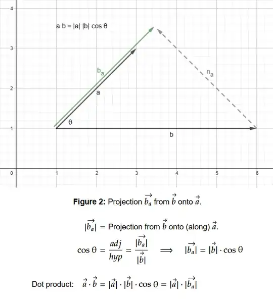

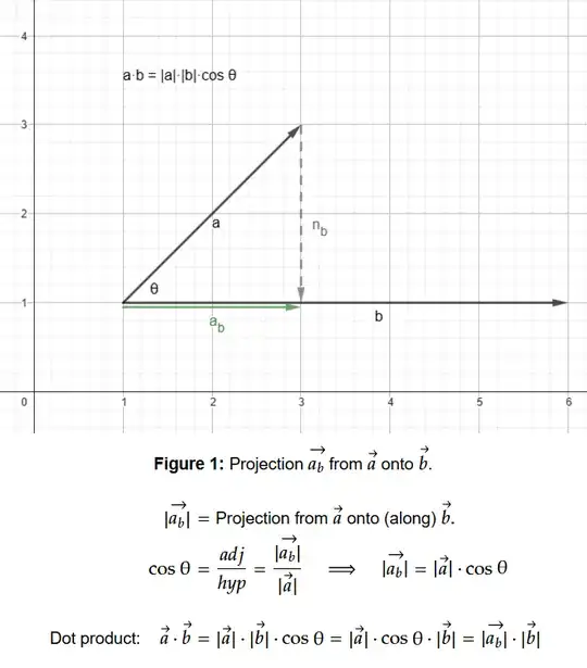

Personally, when thinking about the dot product, three properties come to mind.
Visualizing it in terms of orientation and projection helped me the most back then.
1) Projection:
  • Projection of two vectors, e.g., $\vec{a}$ onto $\vec{b}$, or vice versa.
  • E.g. used in SAT (separating axis theorem), aka HST (hyperplane separation theorem).
  • Important here is, that in order to compute the projection, one has to normalize either $\vec{a}$ or $\vec{b}$, depending on which projection you are interested in ($\vec{a_b}$ or $\vec{b_a}$).
  • $\vec{a}·\vec{b}$ does not give you any useful projection lenth value,
    if $|\vec{a}| \neq 1$ and $|\vec{b}| \neq 1$, only a useful signed orientation value.
  • But $\vec{a}·\hat{b} = l_b \quad → \vec{a_b} = \hat{b} * l_b$.
  • And $\hat{a}·\vec{b} = l_a \quad → \vec{b_a} = \hat{a} * l_a$.
  • This struggled me a while back then, since I wasn't aware of having to normalize one first!

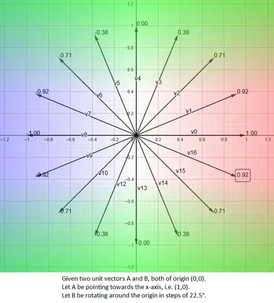

2) Orientation:
Dot Product: Measure of similarity between two vectors
  • Dot Product: Measure of similarity between two vectors.
  • Whether two vectors point in the same, perpendicular, or opposite direction.
    • $\hat{a}·\hat{b} = 1$   → Parallel in same direction.
    • $\hat{a}·\hat{b} > 0$   → Same direction.
    • $\hat{a}·\hat{b} = 0$   → Perpendicular direction.
    • $\hat{a}·\hat{b} = -1$   → Parallel in opposite direction.
    • $\hat{a}·\hat{b} < 0$   → Opposite direction.
  • Very useful, e.g., to determine whether a point lies above or below a polygon, face, or plane.
3) Angle:
  • Dot Product: Cosine of angle theta between the two vectors, if both vectors are normalized:
    $\vec{a}·\vec{b} = |\vec{a}||\vec{b}|\cos(\theta) \quad → \cos(\theta) = \frac{\vec{a}·\vec{b}}{|\vec{a}||\vec{b}|} \quad → \cos(\theta) = \hat{a}·\hat{b}$
  • Angle interval of $\cos\theta = [−1, +1] → \cos^{-1}[-1, +1] = [\piᴿ, 0ᴿ] = [180°, 0°]$:
