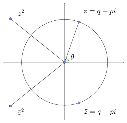

Joseph Bendy's proof can be adapted to show that $\arctan{(p/q)}$ never equals a rational number of degrees when $p$ and $q$ are distinct relatively prime positive integers. The image shows $z = q + pi$ as a complex number and $\theta = \arctan{(p/q)}$. $\arctan{(p/q)}$ is a rational number of degrees if and only if $z^{n'}$ is real for some positive integer $n'$.
The object is to develop recursive formulas for $z^n = a_n + b_ni$. Note that since $z + \bar{z} = 2q$ and $z \cdot \bar{z} = p^2 + q^2$, $z$ and $\bar{z}$ satisfy the quadratic equation $x^2 - 2qx + (p^2 + q^2) = 0$. Therefore: \begin{align*} 1 &= 1 + 0i\\ z &= q + pi\\ z^2 &= 2qz - (p^2 + q^2)\\ z^3 &= 2qz^2 - (p^2 + q^2)z\\ z^4 &= 2qz^3 - (p^2 + q^2)z^2, \end{align*} and so on, each line being $z$ times the previous one. The same series of equations is true if $z$ is replaced by $\bar{z}$. That is, the powers of $z = \{1, z, z^2, z^3, \cdots\}$ satisfy the recursion: \begin{align*} \xi_0 &= 1, \; \xi_1 = z\\ \xi_{n+2} &= 2q\xi_{n+1} - (p^2 + q^2)\xi_n,\tag{1} \end{align*} and so do the powers of $\bar{z}$. Consider that: \begin{align*} z^n &= a_n + b_ni\\ \overline{z^n} &= \bar{z}^n = a_n - b_ni\\[0.5em] \therefore a_n &= \frac{z^n + \bar{z}^n}{2} = \frac{1}{2}z^n + \frac{1}{2}\bar{z}^n\\[0.5em] b_n &= \frac{z^n - \bar{z}^n}{2} = \frac{1}{2}z^n - \frac{1}{2}\bar{z}^n. \end{align*} The sequences $\{a_n\}$ and $\{b_n\}$ are linear combinations of sequences satifying recurrence (1) and therefore themselves satisfy the recurrence. Sequence $\{b_n\}$ is of interest as giving the imaginary parts of $\{z_n\}$: \begin{align*} b_0 &= 0\\ b_1 &= p\\ b_2 &= 2pq\\ b_3 &= 2q \cdot (2pq) - \left(p^2 + q^2\right) \cdot p\\ &\vdots \end{align*} Look at recurrence (1) mod ($p^2 + q^2$) when applied to the $b_n$: \begin{align*} b_0 &\equiv 0 \mkern-12mu \pmod{(p^2+q^2)}\\ b_1 &\equiv p \mkern-12mu \pmod{(p^2+q^2)}\\ b_2 &\equiv 2pq \mkern-12mu \pmod{(p^2+q^2)}\\ b_3 &\equiv 4pq^2 \mkern-12mu \pmod{(p^2+q^2)}\\ &\vdots\\ b_n &\equiv 2^{n-1}pq^{n-1} \mkern-12mu \pmod{(p^2+q^2)}. \end{align*} All the above holds for all $n$. Let $n=n'$ be the specific integer such that $b_{n'} = 0$. For that $n', \; (p^2+q^2) \; | \; 2^{n'-1}pq^{n'-1}$.
Let $s$ be any prime dividing both $p$ and $p^2+q^2$. $s$ divides $p^2$ and therefore divides $q^2$ and $q$. That is, $p$ and $q$ have a common factor, which was ruled out at the start. Similarly $q$ and $p^2+q^2$ can have no common factor. The upshot is that $(p^2+q^2) \; | \; 2^{n'-1}$, so $(p^2+q^2)$ is itself a power of 2. But a parity check shows that is never possible for relatively prime integers $p$ and $q$: $p$ and $q$ can't both be even since they are relatively prime. If one of them is even and the other odd, then $p^2 + q^2$ is odd and therefore not a power of 2. Finally, if both $p$ and $q$ are odd, then $p^2 \equiv 1 \pmod{4}$ and $q^2 \equiv 1 \pmod{4}$, so $(p^2+q^2) \equiv 2 \pmod{4}$ and the only way that is true together with $p^2+q^2$ a power of 2 is when $p = q = 1$, and that is disallowed.
It follows that there is no positive integer $n$ such that $b_n = 0$ and so $\arctan{(p/q)}$ cannot equal a rational number of degrees. $\textbf{QED.}$
