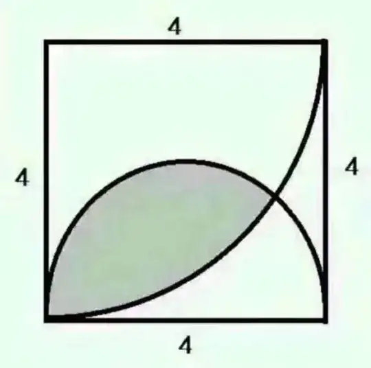

How to find the shaded area crossed by semi-circle of radius 2 and quarter-circle of radius 4? enter image description here

  • I have 2 arctan(2)4pi - 8/5 + 2 arctan(1/2)16pi - 32/5. However arctan(2) and arctan(1/2) are not rational multiple of pi. And this question is supposed to be an elementary school math question, so the answer should be in terms of pi, without trigonometry. – Ed Zeng Feb 06 '18 at 06:14

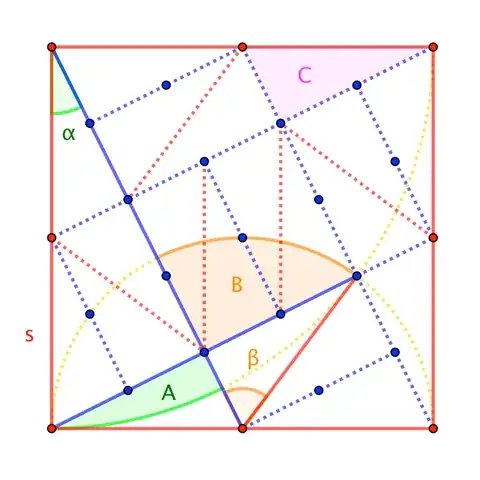

The shaded area is shaped from two intersecting circles like an asymmetric lens! in order to find the area of this lens we simply split it in two parts: enter image description here

Hint.
(This space intentionally left blank.)
Solution.
$$\begin{align} \frac12\cdot\text{target area} &= A + B \\ &= \left( \frac12 \cdot (2s)^2\cdot\alpha - 4 C\right) + \left(\frac12 \cdot s^2 \cdot \beta - C \right) \\[4pt] &= \frac12 s^2\left( 4 \alpha + \beta \right) - 5 C \\[4pt] &=\frac12 s^2 \left( \frac\pi2 + 3\alpha \right)-5 \cdot \frac{1}{20}(2s)^2 \\[4pt] &= \frac12 s^2 \left( \frac\pi2 + 3\operatorname{atan}\frac{1}{2} - 2 \right) \end{align}$$ So, the target area, with $s = 2$, is
$$2 \pi + 12 \operatorname{atan}\frac{1}{2} - 8 $$
Blue
  • 83,939
  • Thanks! I am not sure how to find the area of the arc without using trigonometry though. BTW, what software do you use to draw such nice diagram? – Ed Zeng Feb 07 '18 at 05:30

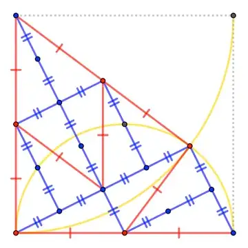

Let $ABCD$ be our square, where $B$ is a center of the circle with the radius $4$ and $AD$ is a diameter of the second circle.
Let these circles be intersected in points $A$ and $E$ and $G$ be the center of the second circle.
Thus, the needed area it's: $$\frac{1}{2}\cdot4^2\cdot2\arctan\frac{1}{2}+\frac{1}{2}\cdot2^2\cdot2\arctan2-S_{ABEG}=$$ $$=16\arctan\frac{1}{2}+4\arctan2-4\cdot2=$$ $$=16\left(\frac{\pi}{2}-\arctan2\right)+4\arctan2-4\cdot2=8\pi-12\arctan2-8.$$
