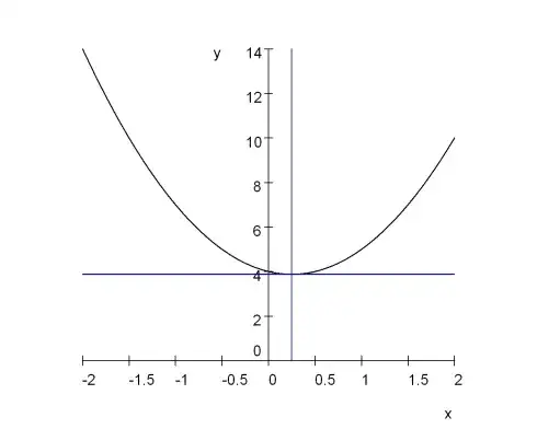

The vertex of a parabola is the point on the axis of symmetry that intersects it (Wikipedia).
The point $(x,y)=(0,0) $ is the vertex of the parabola given by $y=ax^2$. By making the change of coordinates
$$X=x+\frac{b}{2a},Y=y+\frac{b^{2}-4ac}{4a},$$
equation $y=ax^{2}+bx+c$ is transformed into $Y=aX^{2}$, the vertex of which is the point $(X,Y)=(0,0)$, i.e. $(x,y)=\left(-\dfrac{b}{2a},-\dfrac{b^{2}-4ac}{4a}\right)$.
(This change of coordinates is a translation of both axes $x$, $y$, respectively, by $-\dfrac{b}{2a},-\dfrac{b^{2}-4ac}{4a}$.)
Hence, the $x$-coordinate of the vertex of the parabola is $-\dfrac{b}{2a}$.
Edit. Example. Plot of $y=2x^2-x+4$; blue axes: $X=x-1/4,Y=y-31/8$
alt text

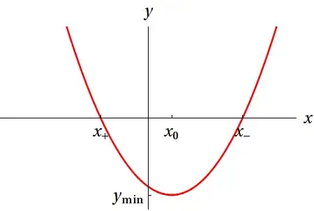

This leads to an interesting question about what happens when the parabola does not have real roots.
It could be argued that the parabola is symetric respect to the vertical line passing through the vertex point. So, the vertex is located in the midpoint between the two roots of $y=0$.
As pointed out before, by completing the square, the parabola equation can be written as $$ y = a(x - x_+)(x - x_-)\,, $$
where $x_+$ and $x_-$ are the roots mentioned above, given by $$ x_\pm = \dfrac{ -b \pm \sqrt{ b^2 - 4 a c} }{2a} \,.$$
Then, the midpoint between $x_+$ and $x_-$ is $$ x_0 = \dfrac12 (x_+ + x_- ) = -\frac{b}{2a} \,.$$
Note that this demonstration is also valid even when there is no real roots for $y=0$ (which is the case when $b^2 < 4a c$), since the complex terms in the last equation are mutually canceled.
Sketch of the parabola:
