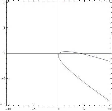

and indeed your parabola looks like
para

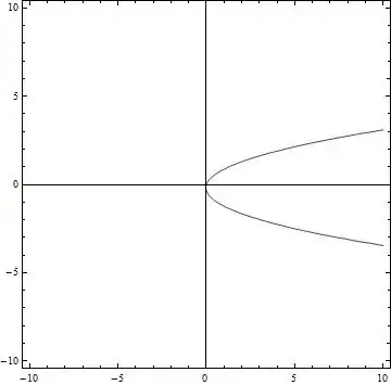

Continuing this example, the sideways parabola looks like this.
It is very slightly shifted and scaled. I leave the rest of algebra up to you. After you find everything you need, for some of them you will need (call this set 2)

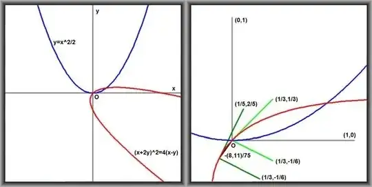

This is actually the duplicate of an answer to the following question: Proving that for each two parabolas, there exists a transformation taking one to the other . According to the theory presented there, it is advantageous to write the OP's equation as follows: $$ 2(x-y) = \frac{1}{2} (x+2y)^2 \qquad \mbox{or} \qquad \eta = \frac{1}{2} \xi^2 $$ Where it is noted that $\;\xi\;$ physically corresponds with "time" . Anyway, it follows that: $$ \left\{ \begin{array}{l} \xi = x+2y \\ \eta = 2(x-y) \end{array}\right. \qquad \Longleftrightarrow \qquad \left\{ \begin{array}{l} x = \frac{1}{3}\xi + \frac{1}{3}\eta \\ y = \frac{1}{3}\xi - \frac{1}{6}\eta \end{array}\right. $$ Giving the "velocities", "accelerations" and "origin" in the parameter equations of the parabola. $$ v_x = v_y = \frac{1}{3} \quad ; \quad a_x = \frac{1}{3} \quad ; \quad a_y = - \frac{1}{6} \quad ; \quad s_x = s_y = 0 $$ In matrix form: $$ \left[ \begin{array}{c} x \\ y \end{array} \right] = \left[ \begin{array}{cc} v_x & a_x \\ v_y & a_y \end{array} \right] \left[ \begin{array}{c} \xi \\ \xi^2/2 \end{array} \right] = \left[ \begin{array}{cc} +\frac{1}{3} & +\frac{1}{3} \\ +\frac{1}{3} & -\frac{1}{6} \end{array} \right] \left[ \begin{array}{c} \xi \\ \eta \end{array} \right] $$ If you believe that a linear mapping transforms a parabola into a parabola then we are done.
Otherwise. An orthogonal coordinate transformation, still according to the same theory, is obtained by a parameter shift $\;\tau$ : $$ \tau = \frac{v_x a_x + v_y a_y}{a^2_x + a^2_y} = \frac{1/3 \cdot 1/3 - 1/3 \cdot 1/6}{1/9 + 1/36} = \frac{2}{5} $$ Resulting in: $$ x = (v_x-a_x\tau)\xi + a_x\eta + (\frac{1}{2}a_x\tau^2-v_x\tau+s_x) = \frac{1}{5}\xi + \frac{1}{3}\eta - \frac{8}{75} \\ y = (v_y-a_y\tau)\xi + a_y\eta + (\frac{1}{2}a_y\tau^2-v_y\tau+s_y) = \frac{2}{5}\xi - \frac{1}{6}\eta - \frac{11}{75} $$ In matrix form: $$ \left[ \begin{array}{c} x \\ y \end{array} \right] = \left[ \begin{array}{cc} +\frac{1}{5} & +\frac{1}{3} \\ +\frac{2}{5} & - \frac{1}{6} \end{array} \right] \left[ \begin{array}{c} \xi \\ \eta \end{array} \right] - \left[ \begin{array}{c} \frac{8}{75} \\ \frac{11}{75} \end{array} \right] = \left[ \begin{array}{cc} \frac{1}{\sqrt{5}} & -\frac{2}{\sqrt{5}} \\ \frac{2}{\sqrt{5}} & \frac{1}{\sqrt{5}} \end{array} \right] \left[ \begin{array}{c} \frac{1}{\sqrt{5}}\xi \\ -\frac{\sqrt{5}}{6}\eta \end{array} \right] - \left[ \begin{array}{c} \frac{8}{75} \\ \frac{11}{75} \end{array} \right] $$ The meaning of this is transforming $\;\eta = \xi^2/2\;$ into the original $\;(x+2y)^2=4(x-y)\;$ by scaling the $\xi$ coordinate with a factor $1/\sqrt{5}$ , scaling the $\eta$ coordinate with a factor $-\sqrt{5}/6$ (i.e. scaling and mirroring), followed by a rotation over an angle $\;\arctan(2)\;$ and a translation over $\;-(8,11)/75$ . Nobody will deny that $\;\eta = \xi^2/2\;$ represents a "standard" parabola and these transformations don't change that fact.
Viewports:
xmin := -5; xmax := 5;                  xmin := -1/3; xmax := 1.1;
ymin := -5; ymax := 5;                  ymin := -1/3; ymax := 1.1;
Colors:
  • Blue: standard parabola $y = x^2/2$
  • Red: original parabola $(x+2y)^2=4(x-y)$
  • Grey: global Cartesian coordinate system / unit vectors of standard parabola.
  • Lime: non-orthogonal coordinate system / unit vectors if "we are done".
  • Green: orthogonal coordinate system if "Otherwise". Note that the system is left handed and that the axis corresponding with "acceleration" does not change / is parallel to the Lime one.
  • Black: translation vector $(s_x,s_y)$ corresponding with "time" $\tau$ needed to travel along the (red) parabola from the origin to that position.
