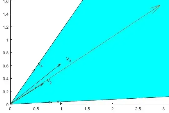

A geometric proof without words :
But with words, it's better.
Let $V_k=\pmatrix{a_k\\b_k}$ and $\theta_k \in I$ its polar angle where $I=(0,\tfrac{\pi}{2})$
The idea is that it suffices to "transfer" the order between fractions $a_k/b_k$ considered as $\arctan(\theta_k)$ and the order of these polar angles $\theta_k$.
With more details :
As $\frac{b_k}{a_k}=\arctan{\theta_k}$, condition :
$$\frac{a_1}{b_1}<\frac{a_2}{b_2}<\ldots<\frac{a_n}{b_n}$$
plainly means that the indices of the vectors are by ascending order of the $\arctan$ of their polar angles, therefore of their polar angles (because function $\arctan$ is increasing on $I=(0,\tfrac{\pi}{2}).$)
Consider the convex cone $(C)$ (rendered with cyan color on the above figure) (see here) generated by the $V_k$s. $(C)$ has generic element $W=\sum c_k V_k$ (all $c_k>0$) which is in-between the two extremal rays $\mathbb{R_+}V_1$ and $\mathbb{R_+}V_n$.
"Being situated between" means that the polar angle of $W$ belongs to interval $(\theta_1,\theta_n).$
In our case, we are with element $W=\sum V_k=\pmatrix{a_1+a_2+\cdots+a_n\\b_1+b_2+\cdots+b_n}$ whose polar angle is in the interval $(\theta_1,\theta_n)$. Finished...
