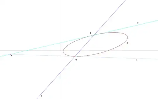

Example
Conic $\mathtt{C} = \left[ \matrix{1 & -\tfrac{7}{6} & -3 \\ -\tfrac{7}{6} & 4 & 1 \\ -3 & 1 & \tfrac{13}{6} } \right] $ and line $\mathbf{L} = \pmatrix{3 \\ -2 \\ -7}$. The polar point is $$\mathbf{P} = \mathtt{C}^{-1} \mathbf{L} = \pmatrix{u \\ v \\ w} = \pmatrix{ \tfrac{11208}{5245} \\ \tfrac{1134}{5245} \\ -\tfrac{390}{1049} } $$
The tangent lines are thus $$\mathbf{T}(\psi) = \pmatrix{ \tfrac{390}{1049} \sin\psi \\ -\tfrac{390}{1049} \cos\psi \\ \tfrac{11208}{5245} \sin\psi - \frac{1134}{5245} \cos\psi }$$
The tangency equation $\mathbf{T}^\top \mathtt{C}^{-1} \mathbf{T}=0$ simplifis to the following:
$$ 1.26602894762909 \cos^2 \psi+0.330351717237625 \cos\psi \sin \psi-1.24876309636214=0 $$
with solution
$$ \begin{cases} \psi = 0.299923260411840 & \mbox{solution 1} \\ \psi =-0.0446792696983973 & \mbox{solution 2} \end{cases} $$
The intersection points are
$$ \begin{align} \mathbf{Q} &= \pmatrix{ -0.231100412938826 \\ -0.141550789771816 \\-0.0585999513246922} & \mathbf{Q} &= \pmatrix{ 0.136962490550640 \\-0.0727785333232919 \\0.0794920768997864 } \end{align} $$
