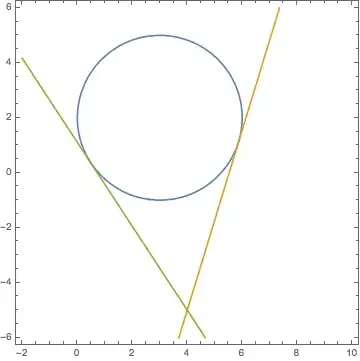

For your example, we have $h=3$, $k=2$, $r=3$ and $\mathbf p=[4:-5:1]$, giving $[3:\pm\sqrt{41}:-5\sqrt2]$ for the unit circle tangents and finally $$\begin{bmatrix}3 & \pm\sqrt{41} & -5\sqrt2\end{bmatrix} \begin{bmatrix}1&-7&11\\7&1&-23\\0&0&15\sqrt2\end{bmatrix} = \begin{bmatrix}3\pm7\sqrt{41} & -21\pm\sqrt{41} & -117\mp23\sqrt{41}\end{bmatrix}$$ as the solution to the problem. These lines and the circle are plotted below:

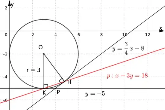

$x^2 + y^2 -6x +4y + 4 = 0$
centre $C(3;\;-2)$ radius $r=3$
$P(4;\;-5)$
Write the equation of the generic line passing through $P$
$y+5=m(x-4)$
adjust it in normal form
$\mathscr{F}:mx -y -4m-5=0$
Calculate the distance $d(m)$ from $\mathscr{F}$ to the centre $C$ of the circle
$$d(m)=\frac{|3m+2-4m-5|}{\sqrt{m^2+1}}$$ The line $\mathscr{F}$ is tangent to the circle if the distance $d(m)$ is equal to the radius
$$d(m)=3\to \frac{|-3-m|}{\sqrt{m^2+1}}=3$$
square both sides $$9+6m+m^2=9m^2+9\to m_1=0;\;m_2=\frac34$$ the two tangents are
$y=-5;\;y=\frac{3}{4}x-8$
Second method
Works with any conic
Find the equation of the polar line of $P$ wrt the circle Substitute
$$x^2\to x_px;\;y^2\to y_py;\;x\to\frac{x+x_p}{2};\;y\to \frac{y+y_p}{2};xy\to \frac{xy_p+yx_p}{2}$$
$$4x-5y-6\,\frac{x+4}{2}+4\,\frac{y-5}{2}+4=0$$
$p:x-3y=18$
The intersection points of this line with the circle are the tangent points of the tangents from $P$ to the circle, namely $K(3,-5);\;H(4.8,-4.4)$
Hope this helps
