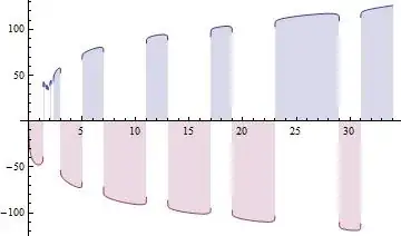

Edit: 16.9.2011
Plot of the 32:nd polynomial:

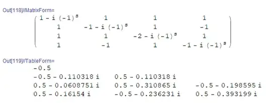

A more eigenvalue like equation:
(*start*)
mmm = 6;
TableForm[Table[Clear[nn, t, n, k, M, x, c];
  nn = mm;
  t[n_, 1] = 1;
  t[1, k_] = 1;
  t[n_, k_] :=
   t[n, k] =
    If[n < k,
     If[And[n > 1, k > 1], -Sum[t[k - i, n], {i, 1, n - 1}], 0],
     If[And[n > 1, k > 1], -Sum[t[n - i, k], {i, 1, k - 1}], 0]];
  M = Table[Table[t[n, k], {k, 1, nn}], {n, 1, nn}];
  MatrixForm[M];
  Det[M];
  FullSimplify[(s /.
     NSolve[Det[M - I*(-1)^(s)*IdentityMatrix[mm]] == 0, s])], {mm, 1,
    mmm}]]
MatrixForm[M - I*(-1)^(s)*IdentityMatrix[mmm]]
(*end*)
where key equation is:
$$\left( \begin{array}{cccccc} 1-i (-1)^s & 1 & 1 & 1 & 1 & 1 \\ 1 & -1-i (-1)^s & 1 & -1 & 1 & -1 \\ 1 & 1 & -2-i (-1)^s & 1 & 1 & -2 \\ 1 & -1 & 1 & -1-i (-1)^s & 1 & -1 \\ 1 & 1 & 1 & 1 & -4-i (-1)^s & 1 \\ 1 & -1 & -2 & -1 & 1 & 2-i (-1)^s \end{array} \right)$$
This gives numerical zeros:
numerical zeros
But those don't have the same consistent signs on the real part.

  • Hmm, that 32nd polynomial looks like it's trying awfully hard to converge to something... – anon Sep 16 '11 at 09:39
  • @anon: I forgot to say that it is a logarithmic plot. – Mats Granvik Sep 16 '11 at 11:28
