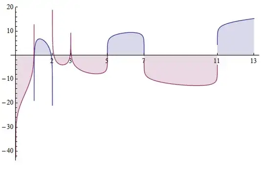

Plotting (the logarithm of) the $11$-th determinant polynomial of the form:
$$P(x,11)=|\log(x) \gcd (n,k)-\phi (n)\log(\gcd (n,k))|$$
(*start*)
nn = 11;
polynomial =
  Det[Table[
    Table[GCD[n, k]*Log[x] - EulerPhi[k]*Log[GCD[n, k]], {k, 1,
      nn}], {n, 1, nn}]];
Plot[{Log[polynomial], -Log[-polynomial]}, {x, 0, nn + 2},
 Filling -> Axis, Ticks -> {Prime[Range[nn + 2]]}]
(*end*)
Eleventh determinant polynomial with prime number as zeros

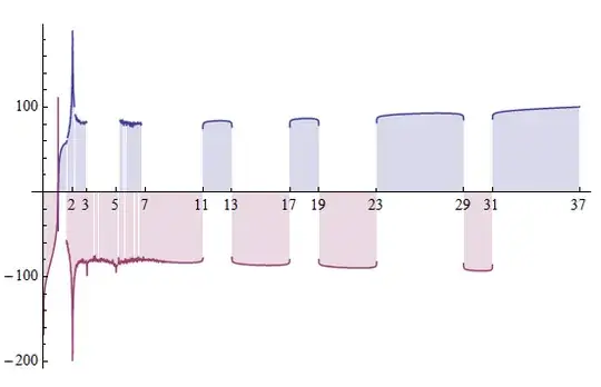

(*start*)
nn = 35;
polynomial =
  Det[Table[
    Table[GCD[n, k]*Log[x] - N[EulerPhi[k], 80]*Log[GCD[n, k]], {k, 1,
       nn}], {n, 1, nn}]];
 Filling -> Axis, Ticks -> {Prime[Range[nn]]}]
N[polynomial]
(*end*)
Plotting the $35$-th determinant polynomial of the form:
$$P(x,35)=|\log(x) \gcd (n,k)-\phi (n)\log(\gcd (n,k))|$$
Thirtyfifth determinant polynomial with prime number as zeros
The numerical inaccuracies at the beginning of the plot are probably because the magnitude is very large $|\log(\text{plot})| \approx 100$.
