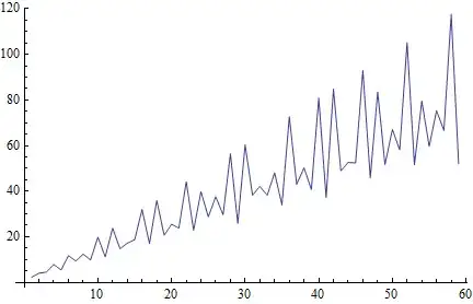

This related matrix seems to give the partial sums of the Euler totient times a factor:
(*Mathematica*)
Clear[n, s, a, A];
mm = 60;
Monitor[eig1 = Table[
   nn = ii;
   a = Table[N[0], {n, 1, nn}];
   a[[1]] = ii;
   A = Table[Table[a[[GCD[n, k]]], {k, 1, nn}], {n, 1, nn}];
   Max[Eigenvalues[A]], {ii, 1, mm}], ii]
ListLinePlot[Differences[%]]
(*end*)
