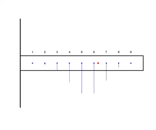

Perhaps by considering this question with a concrete physical example, it will provide some intuition.
Consider a beam of length $L = 10$ (you can pick your favorite units) attached to a wall. Now, at positions $1, 2, \ldots, 9$ hang weights $w_1,w_2,\ldots,w_9$. For simplicity, let's assume $\sum_{n=1}^9 w_n = 1$.
Then the center of mass of the beam is $c = \sum_{n=1}^9 n w_n$. below is an example picture, with the weights in blue (heights proportional to weight) and the center of mass in red.
In a probabilistic setting, our weights correspond to probabilities and $c = \mathbb E X$ where $X$ takes on the values $1,2,\ldots,9$ with probabilities $w_1,w_2,\ldots,w_9$, respectively.
Now, to explain how $c = \mathbb E X = \sum_{n=0}^9 \mathbb P(X > n) = \sum_{n = 0}^9 \sum_{k=n+1}^9 w_k$ comes about, expanding out the latter sum we have $$ c = (w_1 + \cdots + w_9) + (w_2 + \cdots + w_9) + \cdots + (w_9) \>, $$ so, $w_1$ appears once, $w_2$ appears twice, $w_3$ appears three times, etc. Hence $c = \sum_{n=1}^9 n w_n$.
In terms of the beam, we can think of the expression $\sum_{n=0}^9 \mathbb P(X > n)$ in the following way. Standing at zero, look out to the right and count up all the weights in front of you. Now, move one step to the right and repeat this process, adding the result to your initial sum. Continue this process until you get out to position 9, at which point there are no more weights in front of you.
The resulting sum is the center of mass, or, in probabilistic terms, the expectation $\mathbb E X$.
Extending this intuition to discrete random variables taking on non-integer values is straightforward. The extension to continuous variables is also not difficult.
