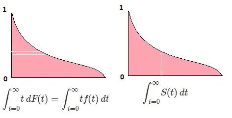

Copied from Cross Validated / stats.stackexchange:
where $S(t)$ is the survival function equal to $1- F(t)$. The two areas are clearly identical.
Henry
  • 169,616
    The two areas may be clearly identical, but what is unclear is why the integrals equal match the diagrams. Moreover, it appears that this proof does not apply in general: it only works when the random variable $X$ in question possesses a density. – pre-kidney Jul 19 '19 at 05:13
  • @pre-kidney In the left hand diagram I would have thought it was sensible to regard the white bordered slice as essentially having width $t$ and height $\delta F(t)$, so the area is $\int t, dF(t)$ while the right hand diagram white bordered slice as essentially having width $\delta t$ and height $S(t)=1-F(t)$ so an area which is $\int S(t) , dt$, with this duality working for all non-negative distributions discrete or continuous. You are correct that $\int t, f(t) , dt$ is only meaningful when there is a density function, since $f(t)$ is that density. – Henry Jul 21 '19 at 17:21
    Certainly there are more issues than just the surface level you acknowledge - beyond just the fact that $\int_{t=0}^{\infty}t\ f(t)\ dt$ is meaningless in general, the way you bring in the integral $\int_{t=0}^{\infty} t\ dF(t)$ (which, by the way, I still don't know exactly what quantity you are referring to when $X$ lacks a density) seems to be via Riemann sum approximations to a Riemann integral, which cannot work for the general case (it would require a Lebesgue integral, at least in the standard formulations of probability theory...) – pre-kidney Jul 21 '19 at 21:17
  • I think it should be $dS(t)$ but not $dF(t)$ in the left equation as the function of the curve is $S(t)$. – mxdxzxyjzx Aug 11 '20 at 00:49
