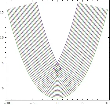

Here's a plot of a bunch of parabola parallels:
parabola parallels
