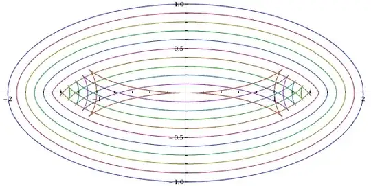

In the following picture, the outer curve is an ellipse with semiaxes $2$ and $1$, and the curves inside it are parallel curves to it, at distances separated $\tfrac1{10}$.

OK, thanks. I suspected as much, but my math is weak enough that I wasn't sure. And your diagram very nicely illustrates how it breaks down. – Daniel R Hicks Sep 15 '11 at 18:43
