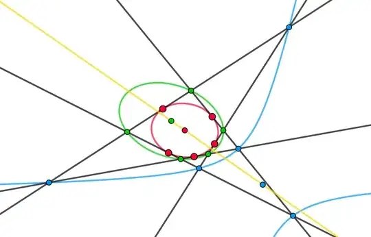

Yesterday while playing with the Geogebra application, I discovered a fairly initial theorem in the conic sections, and I don't know if it was already discovered or not, please if there are references on the subject, please mention them, and also if someone manages to prove it, that would be nice. enter image description here
If we have a conic section, and we choose five points from it and draw the tangents in them, and we designate the ten points to intersect the tangents, and then we choose five points from which a non-degenerate conic section passes, and we draw that section, and then we draw the conic section that passes through the remaining five points, then the centers of the three conic sections will lie on one line.
    Note: Applying an appropriate projective transformation, we may assume the initial conic is a circle. – Blue Jun 30 '24 at 07:28
  • I would like to point out an additional note, which is that there is more than one way to choose the five points out of the ten to create a non-degenerate conic section. The centers of all of these conic sections will not lie on one line, but we will obtain different lines depending on the method of choosing the points. – زكريا حسناوي Jun 30 '24 at 09:32

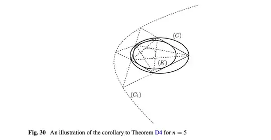

Why are they in a tangential pencil? Now we have to get into the weeds of Poncelet's Theorem. A good but challenging reference is Poncelet's porism: a long story of renewed discoveries, I. Your diagram is echoed in Figure 30 of that paper: Poncelet corollary
The general Poncelet Porism setup takes $n$ points on a conic and then connects them to make a polygon which circumscribes a new conic (and by making more connections circumscribes more nested conics). These conics belong to a common conic pencil. Your construction intersects the tangents of the $n$ points and creates conics. This is the dual of the general construction, and the result is conics that belong to a tangential pencil (which is the dual of a normal pencil).
