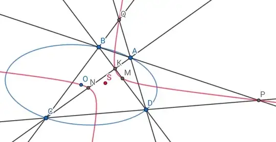

I found the solution to one of the interesting problems of conic sections a little while ago and then I searched through this site and found an analytical approach, I am now going to provide an engineering approach and I hope to get proof in the comments
We know that for five points in the plane, four of which do not lie on the same line, there is a single conic segment passing through these points, so there is an infinite number of conic sections that Passing through four points, the centers of this family of conic sections make a one-dimensional geometric shop that turns out to be a conical section. What I did was create five points of this conic cutting using a ruler and compass.
We are looking for the geometric locale of the center of the conical section that passes through the points: $A,B,C,D$ The desired geometric locus is the conical section that passes through the following five points:
$P=AB∩CD$
$Q=AD∩BC$
$K=AC∩BD$
$M$ is mid point $B,D$
$N$ is mid point $A,C$
    Your construction is obvious, because lines $AB$ and $CD$ form a conic section with centre $P$, ditto for the other couples of lines. And there is always a conic through (for instance) $ABCD$ and $A'$, where $A'$ is the reflection of $A$ about $M$ (you could add to your list all the other midpoints, by the way). The problem is that of proving that the locus of the centre is a conic section. – Intelligenti pauca Apr 02 '24 at 21:51
    You are right, although this geometric object is a conic section on the GeoGebra program, this must be proven mathematically, and I really hope to reach a geometric proof, but I have not succeeded in this yet. @Intelligentipauca – زكريا حسناوي Apr 03 '24 at 02:21
