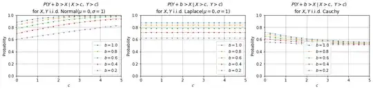

Examples
If $X,Y$ i.i.d. Normal$(\sigma)$, then $$\lim_{c\to\infty}p_{b,c}=1$$ because
$${f(c+b)\over f(c)}={\exp\left(-{1\over2}{\left({c+b\over\sigma}\right)^2}+{1\over2}{\left({c\over\sigma}\right)^2}\right)}=\exp\left({-2bc-b^2\over2\sigma^2}\right)\to0\ \ \text{as $c\to\infty$}.$$
If $X,Y$ i.i.d. Laplace$(\sigma=\sqrt{2}\,\alpha)$, then $$\lim_{c\to\infty}p_{b,c}=1-{1\over2}\exp\left(-{b\over\alpha}\right)$$ because $${f(c+b)\over f(c)}={\exp\left(-{|c+b|\over\alpha}+{|c|\over\alpha}\right)}=\exp\left(-{b\over\alpha}\right)$$
If $X,Y$ i.i.d. Cauchy$(\sigma=\infty)$, then $$\lim_{c\to\infty}p_{b,c}={1\over2}$$ because $${f(c+b)\over f(c)}={(1+(c+b)^2)^{-1}\over (1+c^2)^{-1}}\to1$$
Here are typical plots for these examples, obtained by numerical integration using Eq.(1) (confirmed also by Monte Carlo simulation):
NB: In general, $p_{b,c}$ can't be less than ${1\over2}$, because the bivariate p.d.f.s are symmetrical in their arguments (i.e. $f(x,y)=f(y,x)$); furthermore, the above three examples suffice show that $\lim_{c\to\infty}p_{b,c}$ may be any value in the interval $\left[{1\over2},1\right]$.
