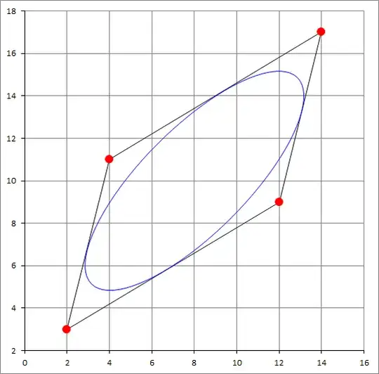

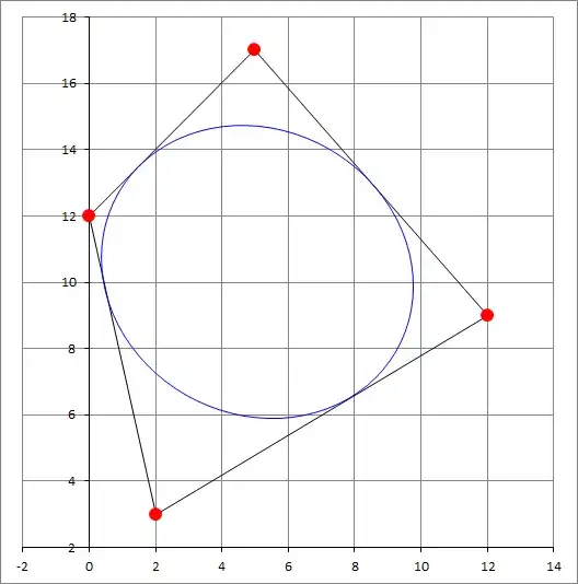

I've tested the above procedure for the convex quadrilateral with vertices $\mathbf{p1} = (2,3) , \mathbf{p_2} = (12,9), \mathbf{p_3} = (5,17), \mathbf{p_4} = (0, 12) $ And an angle of inclination of the major or minor axis of $60^\circ$. The figure below shows the resulting ellipse, which validates the method outlined above.
As another example, I took $\mathbf{p1} = (2,3) , \mathbf{p_2} = (12,9), \mathbf{p_3} = (14,17), \mathbf{p_4} = (4, 11) $ And an angle of inclination of the major or minor axis of $45^\circ$
