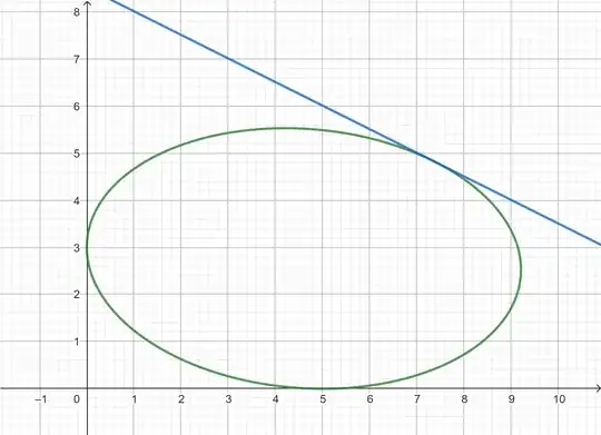

Here's an example with $a= 5, b = 3$, $\mathbf{n }= [1, 2]^T , \mathbf{r_0 } = [5, 6]^T $
Thank you all.

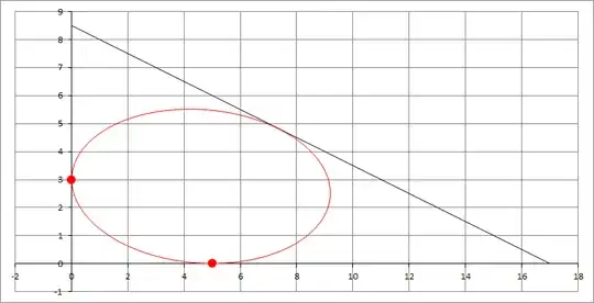

To find the ellipse tangent to $y=0$ at $(5,0),$ tangent to $x=0$ at $(0,3)$ and tangent to $(x-5)+2(y-6)=0$ or $-\frac1{17}x-\frac2{17}y+1=0,$ we set up five equations in essentially five unknowns by substituting the points in the general equation $$ax^2+bxy+cy^2+dx+ey+f=0,$$ substituting the points and slopes there ($x=0,y=3,dx=0$ and $x=5,y=0,dy=0$) in $$(2ax+by+d)dx+(2cy+e+bx)dy=0,$$ and for the dual $$(cf-\frac{e^2}4)X^2+(\frac{de}2-bf)XY+(af-\frac{d^2}4)Y^2+(\frac{be}2-cd)X+(\frac{bd}2-ae)Y+(ac-\frac{b^2}4)=0$$ substitute $(X,Y)=(-\frac1{17},\frac2{17}),$ seeing as the corresponence goes through $xX+yY+1=0.$
$\begin{align}&5^2a+5d+f&=0\\&3^2c+3e+f&=0\\&10a+d&=0\\&6c+e&=0\\&\frac{4cf-8bf+16af-e^2+4de-34be+136ae-4d^2+68cd-68bd+1156ac-289b^2}{34^2}&=0\end{align}$
Solving gives the double line through $(5,0)$ and $(0,3)$ or a multiple of $$2601x^2+750xy+7225y^2-26010x-43350y+65025=0.$$ solution ellipseThis generalizes.
