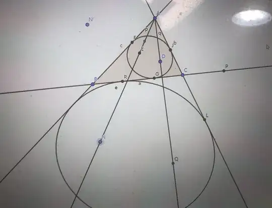

We can think of an incircle and three excircles of a triangle. So the question is : do exellipses exist? Inellipses do exist, and there are a number of studies on it such as the Steiner Ellipse and Marden's Theorem. However, I couldn't find any information on the 'exellipse' ; the ellipse that behaves like an excircle.
Am I getting the name wrong? I expected it to be 'exellipse', but it seems that the word does not exist at all. Also, I would like to find out whether the properties of the incircle and the excircle still holds when it comes to inellipses and 'exellipses'.
The following picture expresses both the inellipse and the 'exellipse' of a triangle. (Sorry for bad resolution.)

    See, for instance Wikipedia's "Circumconic and inconic" entry. Once you generalize circles to ellipses, it's not long before parabolas and hyperbolas get added to the mix; at that point, the "in/ex" distinction starts to fade away, leaving only the essential property of tangency with the side-lines of the triangle, and we just use "inconic" as the catch-all term, regardless of how the curves relate to the interior of the triangle. – Blue Feb 21 '22 at 12:17
  • @Blue understood. Are there any papers or theorems related to the picture? – Vue Feb 21 '22 at 13:29

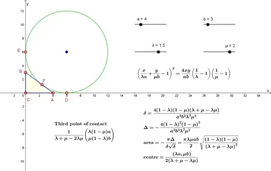

  • @Vue You could export your picture to clipboard in Geogebra, and then paste to any other graphical software and save as different file types you wanted. – Ng Chung Tak Feb 22 '22 at 00:21
Using skew (axes) transformation,
$$(x',y')=(x+y\cos \omega,y\sin \omega)$$
You could always generate a two-parameter family of ellipse touching the three lines defining $\Delta ABC$,
$$ \left( \frac{x}{\lambda a}+\frac{y}{\mu b}-1 \right)^2=\frac{4xy}{ab} \left( \frac{1}{\lambda}-1 \right) \left( \frac{1}{\mu}-1 \right)$$
which touches the axes at $A(\lambda a,0)$ and $B(0,\mu b)$ and the line $\dfrac{x}{a}+\dfrac{y}{b}=1$.
For touching ellipse, $$(1-\lambda)(1-\mu)(\lambda+\mu-\lambda \mu)>0$$
In particular, $\lambda,\mu \in (0,1)$ gives inscribed ellipse.
