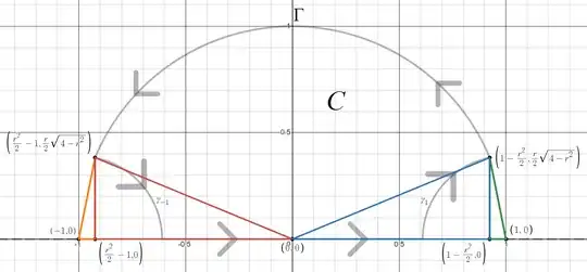

Next, we define a counterclockwise contour $\mathcal{C} = [r-1,1-r] \cup \gamma_1 \cup \Gamma \cup \gamma_{-1}$ where
$$ \begin{align} \gamma_1 &:= \left\{1-re^{-it}: t\in \left[0,\arcsin\left(\frac{\sqrt{4-r^{2}}}{2}\right)\right]\right\} \\ \Gamma &:= \left\{e^{it}: t \in \left[\arccos\left(1-\frac{r^{2}}{2}\right),\pi-\arccos\left(1-\frac{r^{2}}{2}\right)\right]\right\} \\ \gamma_{-1} &:= \left\{re^{-it}-1: t \in \left[-\arcsin\left(\frac{\sqrt{4-r^{2}}}{2}\right),0\right]\right\}\\ \end{align} $$
with the restriction $0 < r \ll 1$.

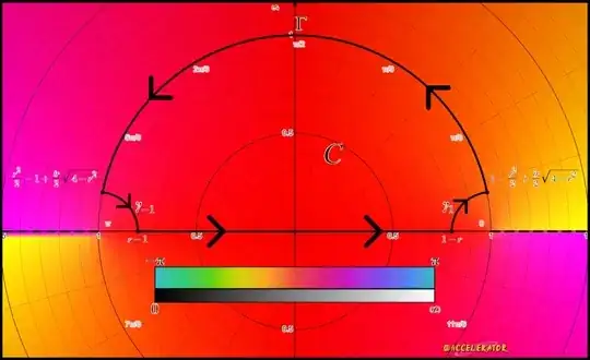

Here is a visual using the standard domain coloring with shading.
(IDK why my PC misaligns that "color break", or however you call it, on the left side. Must be a compiling glitch‍♂️)
I'll briefly explain how we can come up with these subsets of the contour and skip the messy algebra and geometry.
(1) We find the intersections of the circles $x^2+y^2=1$, $(x-1)^2+y^2=r^2$, and $(x+1)^2+y^2=r^2$. They are $\left(\frac{r^{2}}{2}-1,\frac{r}{2}\sqrt{4-r^{2}}\right)$, $\left(1-\frac{r^{2}}{2},\frac{r}{2}\sqrt{4-r^{2}}\right)$, $\left(\frac{r^{2}}{2}-1,-\frac{r}{2}\sqrt{4-r^{2}}\right)$, and $\left(1-\frac{r^{2}}{2},-\frac{r}{2}\sqrt{4-r^{2}}\right)$. Only the first two are relevant.
(2) To find how many radians we need to connect $\gamma_1$ and $\gamma_{-1}$ to $\Gamma$, we construct four right triangles such that their top vertices touch where the contours should intersect.
(3) We assign each triangle a variable, say $\theta$ or something, and solve for each variable via trigonometry. E.G. one of the triangles on the far left can have a $\theta$ next to the point $z=-1$, and we find that the amount of radians needed to connect $\gamma_{-1}$ and $\Gamma$ is $\displaystyle \theta = \arcsin\left(\frac{\sqrt{4-r^{2}}}{2}\right)$ obtained from $\displaystyle \sin(\theta) = \frac{\frac{r}{2}\sqrt{4-r^{2}}}{r}$.
Here is a visual of what's happening.
To convince myself I didn't make some silly algebra mistake somewhere, I programmed a manual animation of how the contour behaves as each radius $r \to 0^+$. You can view it here. In that link, when you drag the $r$ slider, the contour maintains its shape as a closed contour along with the right triangles.
