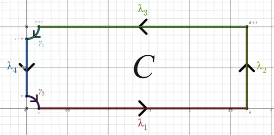

and a contour $C$ that travels counterclockwise through the union of sets, in order,
$$ \begin{align} \color{#9E0000}{\lambda_1} &:= [r,L] \\ \color{#9E9300}{\lambda_2} &:= \left\{L+it\,:\,t\in[0,1]\right\}\\ \color{#3F9E00}{\lambda_3} &:= \left\{i-t\,:\,t\in[-L,-r]\right\}\\ \color{#00989E}{\gamma_1} &:= \left\{re^{-it}+1\,:\,t\in\left[0,\frac{\pi}{2}\right]\right\}\\ \color{#0062C3}{\lambda_4} &:= \left\{-it\,:\,t\in[r-1,-r]\right\}\\ \color{#68009E}{\gamma_2} &:= \left\{-re^{-it}\,:\,t\in\left[\frac{\pi}{2},\pi\right]\right\}\,.\\ \end{align} $$
Here, we let $\displaystyle 0<r<\frac{1}{2}\ll L$. I've provided a visual down below that matches exactly what the union of sets is, down to the exact RGB/hexadecimal colors.

Integrating over these sets, we have
$$ \oint_{C}f = \int_{\color{#9E0000}{\lambda_1}}f + \int_{\color{#9E9300}{\lambda_2}}f + \int_{\color{#3F9E00}{\lambda_3}}f + \int_{\color{#00989E}{\gamma_1}}f + \int_{\color{#0062C3}{\lambda_4}}f + \int_{\color{#68009E}{\gamma_2}}f\,. $$
Because $f$ is holomorphic on the simply connected open domain $\mathbb{C}\,\backslash\left\{n \in \mathbb{Z}\,:\,in\right\}$, $C$ is homologous to $0$, and $C$ is a piecewise, smooth, and closed loop, we use Cauchy's Integral Theorem to get
$$ \oint_{C}f = 0\,. $$
