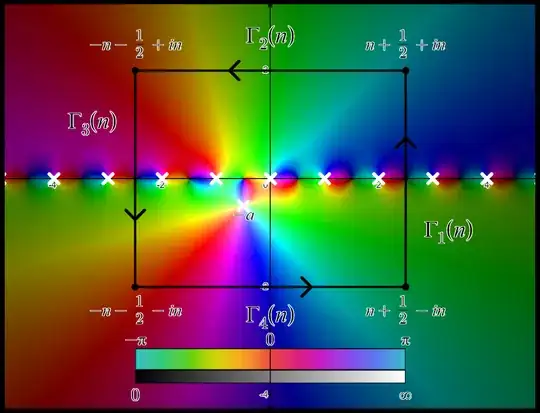

Here is a visual of what the contour looks like with the given function's domain coloring. Note that the domain coloring will vary depending on $-a$.

PROOF (2): First, let $\gamma = \gamma(n)$ represent a sequence of rectangular contours such that $\gamma(n) = \Gamma_1(n) \cup \Gamma_2(n) \cup \Gamma_3(n) \cup \Gamma_4(n)$, shown in the cropped screenshot above. We construct a sequence of contour integrals $\displaystyle\oint_{\gamma(n)}f$ such that $\displaystyle\oint_{\gamma(n)}f$ converges as $n \to \infty$. Notice as the contour grows bigger, none of the integer poles ever touch it because, from the original problem, the contour has been judiciously chosen such that both $\Gamma_1(n)$ and $\Gamma_3(n)$ always lie directly in between two poles. A visual can be seen here on Desmos by playing with the slider $n$ I made. Since $a$ is not an element of $\gamma$ and is fixed, the contour eventually encloses $-a$ as it grows bigger, no matter how far $-a$ is from the origin.
