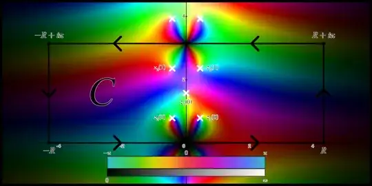

Let $z \mapsto \displaystyle \frac{z^{2}e^{2z}\left(e^{z}-1\right)^{3}\left(e^{z}+1\right)^{3}}{\left(e^{2z}+1\right)\left(6e^{4z}+e^{8z}+1\right)}$ and define it by the holomorphic function $\displaystyle f: \mathbb{C} \backslash \left\{n \in \mathbb{Z}: z_1(n), z_2(n), z_3(n)\right\} \to \mathbb{C}$. The simple poles excluded from the domain are
$$ \begin{align} z_{1}(n)&=\frac{i\pi}{2}\left(2n+1\right) \\ z_{2}(n)&=\frac{1}{4}\ln\left(3-2\sqrt{2}\right)+\frac{i\pi}{4}\left(2n+1\right) \\ z_{3}(n)&=\frac{1}{4}\ln\left(3+2\sqrt{2}\right)+\frac{i\pi}{4}\left(2n+1\right) \end{align} $$
which are obtained from finding the zeroes of $\displaystyle \frac{1}{f}$. We also construct a rectangular box contour $C$ with vertices $(-R,0)$, $(R,0)$, $(R,R+i\pi)$, and $(-R,-R+i\pi)$ where $R$ is sufficiently large such that $R \gg \displaystyle \frac{1}{4}\ln(3+2\sqrt{2})$. Below, I provide a visual I made of what $C$ looks like in the phase plot of $f$ with domain coloring and shading.
Contour Plot

Here, we will denote $\mathcal{P}$ as the set of poles inside $C$, which is $\left\{z_1(0), z_2(0), z_2(1), z_3(0), z_3(1)\right\}$.
