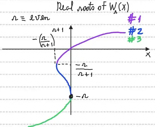

Consider the following equation $$x\bigg( 1 + \frac{x}{r} \bigg)^r = x\cdot e_r(x)= z$$ assuming $r \in Q$ and $z \in C$. The solution $x$ is the so-called Lambert-Tsallis function, $W_r(z)$, proposed by R. V. Ramos (please see some answers in my profile). Also, $[e_r(x)]^\alpha = e_{r\alpha}(x\alpha)$. As can be seen, $W_r(z)$ is a multivalued function and it has a lot of interesting properties.
Now, one can write your problem like
$$-14x\bigg(1 -\frac{x^{10}}{14}\bigg) = -19$$ $$x \cdot e_1 \bigg(-\frac{x^{10}}{14}\bigg) = \frac{19}{14}$$ lets raise to $\color{red}{r=10}$ $$x^re_r \bigg(-\frac{r}{14}x^{10}\bigg) = \bigg(\frac{19}{14}\bigg)^r$$ which produces $$\frac{W_r\bigg[ -\frac{r}{14}\bigg(\frac{19}{14}\bigg)^r\bigg]}{-\frac{r}{14}} = x^r$$
raising again to ^$\frac{1}{r}$ we have
$$ \color{red} {x = \frac{19/14}{1 + \frac{W_r(z)}{r} } }$$
with $z= -\frac{r}{14}\bigg(\frac{19}{14}\bigg)^r$
Properties:
  1. $W_r(z)$ when $r \in Z_+$ has $r+1$ values. In your case $r=10$ so $x$ will have 11 solutions (we already know)
  2. The real roots of $W_r(z)$ when $r$ is even will assume 3 branches (The Lambert function has 2 real branches and it looks like the picture below. real roots of Lambert-Tsallis function with r even
Results $W_{10}(z) = \{ 1.5265 + 2.4833i, 1.5265 - 2.4833i, -2.2131 + 7.3439i, -2.2131 - 7.3439i, -7.7444 + 9.9328i, -7.7444 - 9.9328i, -13.6206 + 9.2325i, -13.6206 - 9.2325i, -19.7383 + 0.0000i, -18.0793 + 5.5122i, -18.0793 - 5.5122i\} $ which produces $x = \{ 1.1252 - 0.2424i, 1.1252 + 0.2424i, 0.9224 - 0.8699i, 0.9224 + 0.8699i 0.2951 - 1.2993i, 0.2951 + 1.2993i, -0.4996 - 1.2740i, -0.4996 + 1.2740i, -1.3936 + 0.0000i, -1.1462 - 0.7820i, -1.1462 + 0.7820i\} $
In your problem, you can see that $z= -\frac{10}{14}\bigg(\frac{19}{14}\bigg)^{10} < z_b=-(\frac{r}{r+1})^{r+1} = -\frac{10}{11}^{11}$ so there is only one real root to $W_{10}(z)$ and, as a consequence, to $x$.
