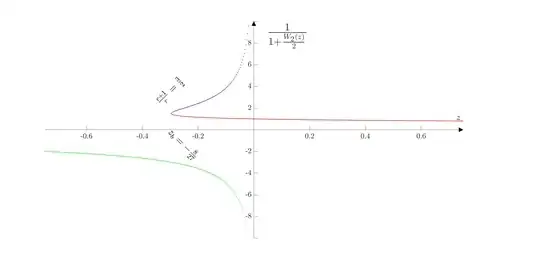

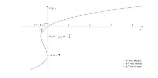

As mentioned before, you already have very good answers, but I would like to add a little bit more. In the last few years, I've working with a new special function, the Lambert-Tsallis, that can help you. You could take a look at the answers 1 and 2.
After this, I will focus on the following equation and this answer is a complement of most of previous comments, specially that one of @Basj. Beggining with the equation:
$$y^3 -py -q=0$$ $$\therefore -p\cdot y \bigg(1 - \frac{y^2}{p} \bigg) = q$$ $$\therefore y \cdot\bigg(1 - \frac{y^2}{p} \bigg) = -\frac{q}{p}$$ $$\therefore y \cdot e_1\bigg(- \frac{y^2}{p} \bigg) = -\frac{q}{p} \text { , look at solutions linked}$$
Raising to $\color{red}{r=2}$, one has
$$\therefore y^r \cdot e_r\bigg(- r\frac{y^2}{p} \bigg) = \bigg(-\frac{q}{p} \bigg)^r $$ $$\therefore W_r{\bigg[\frac{-r}{p}\bigg(\frac{-q}{p} \bigg)^r \bigg]} = \frac{-r}{p}y^r$$
$$\therefore y^r = \frac{W_r{\bigg[\frac{-r}{p}\bigg(\frac{-q}{p} \bigg)^r \bigg]}} { \frac{-r}{p}}$$
$$\implies \color{blue}{y = \frac{-q/p} {1 + \frac{W_r(z)}{r} }}$$
with $\color{red}{z = \bigg[\frac{-r}{p}\bigg(\frac{-q}{p} \bigg)^r \bigg]}$.
Following, one can take a look to illustration of the real values of $W_2(z)$. Actually, $W_2(z)$ is a multivalued function with 3 values. At the illustration, there are 3 real branches, defined in 3 ranges ( $-\infty <z$, $z_b \leq z \leq 0$ and $ 0 \leq z$). Thus, for $0 \leq z$ and $-\infty <z$ there are 2 complex values that are not illustrated meanwhile in the second region, $z_b \leq z \leq 0$, there is no complex values.
The value of $z_b$ is analytical and two of the corresponding value of $W_r(z_b)=w_b=-\frac{r}{r+1}$ with double multiplicity. For the case $r=2$ the other root is $-r^2 +2r/(r+1)$.
Looking at $W_2(z)$ the first and second branches have the property $1 + \frac{W_r(z)}{r} > 0$, so in the range $z_b \leq z \leq 0$ two values of $y$ will have the same sign of $-q/p$ and the other value the opposite. For $z>0$ the only real root will have the same property. However, for $z<z_b$ only the thirs branch is responsible for the real root of $y$, but in this case the sign of $y$ is the same sign of $q/p$.
Once the solution $y$ is expressed in terms of $W_2(z)$ it is easy to understand that $y$ has 3 values. Looking back back to $\color{blue}{y = \frac{-q/p} {1 + \frac{W_r(z)}{r} }}$ it is interesting to attempt in the second figure the behaviour of real values of $\frac{1}{1 + W_2(z)/2}$
