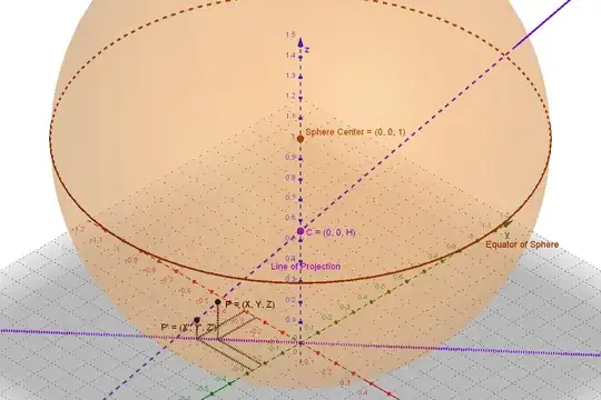

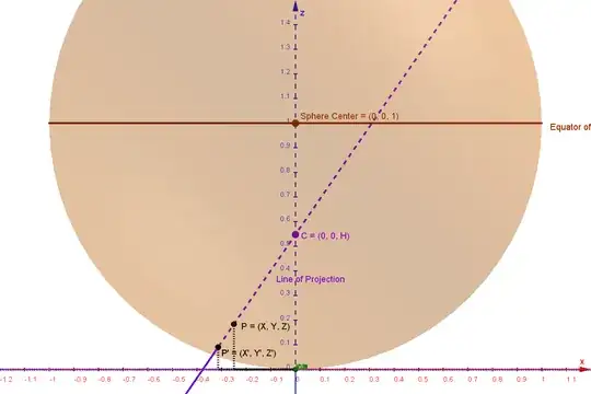

I have a sphere of radius $1$ centered on the point $(0, 0, 1)$.
I also have a point $C = (0, 0, H)$ where $0 < H < 1$ from which to project objects onto the sphere. It is located inside the lower half of the sphere, but importantly is NOT the center of the sphere OR on the surface of the sphere.
Finally, I have a point $P = (X, Y, Z)$ where $0 < Z < H$, located inside (but not at the center or surface of) the sphere, which I want to project onto the lower half of the sphere from $C$ to form the projected point $P'$.
How do I find the 3D coordinates of $P' = (X', Y', Z')$ in terms of $H$, $X$, $Y$, and $Z$?
Picture showing the setup described above in an isomorphic view
Picture showing the setup described above viewed straight down the y-axis
All the information I can find online about projecting things onto spheres assumes that the projective point is either in the center of the sphere or on the surface of the sphere, neither of which is the case for me.

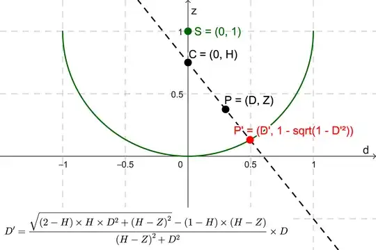

I figured out a way to do it by transforming it the 3D problem into a pair of 2D problems.
To recap, we have a sphere centered on $S = (0, 0, 1)$ with a radius of $1$; a center of projection $C = (0, 0, H)$ where $0 < H < 1$; and a point to be projected $P = (X, Y, Z)$ where $0 < Z < H$.
First, look at a cross-section of the problem in the plane defined by $S$, $C$, and $P$, with a vertical $z$-axis and a horizontal $d$-axis. In this 2D cross-section we have the simple problem of finding the intersection of a line through $C$ and $P$ with the lower-semicircle centered on $S$, where $S = (0, 1)$, $C = (0, H)$, $P = (D, Z)$, and $D = \sqrt{X^2 + Y^2}$. The equation of the semicircle is $z(d) = 1 - \sqrt{1 - d^2}$, and the equation of the line is $z(d) = H + \frac{Z - H}{D} × d$. Setting those equations equal to each other and solving for $d$ gives two answers, one negative and one positive. The one we want is the positive solution, which gives the horizontal distance of the projected point from the $z$-axis: $D' = \frac{\sqrt{(2 - H) × H × D^2 + (H - Z)^2} - (1 - H) × (H - Z)}{(H - Z)^2 + D^2} × D$. The vertical coordinate of the projected point is then easily found to be $Z' = 1 - \sqrt{1 - (D')^2}$.
Second, look into the plane perpendicular to the $z$-axis that passes through $P$. In this reference frame, $P = (X, Y)$. To find $X'$ and $Y'$, we simply need to divide both coordinates by $D$ to normalize them and multiply them by $D'$ to scale them to the new distance. The division by $D$ cancels with the multiplication by $D$ in $D'$, giving $X' = \frac{\sqrt{(2 - H) × H × D^2 + (H - Z)^2} - (1 - H) × (H - Z)}{(H - Z)^2 + D^2} × X$ and $Y' = \frac{\sqrt{(2 - H) × H × D^2 + (H - Z)^2} - (1 - H) × (H - Z)}{(H - Z)^2 + D^2} × Y$.
Thus,
$$ P' = \begin{pmatrix} \frac{\sqrt{(2 - H) × H × (X^2 + Y^2) + (H - Z)^2} - (1 - H) × (H - Z)}{(H - Z)^2 + (X^2 + Y^2)} × X,\\ \frac{\sqrt{(2 - H) × H × (X^2 + Y^2) + (H - Z)^2} - (1 - H) × (H - Z)}{(H - Z)^2 + (X^2 + Y^2)} × Y,\\ 1 - \sqrt{1 - \left(\frac{\sqrt{(2 - H) × H × (X^2 + Y^2) + (H - Z)^2} - (1 - H) × (H - Z)}{(H - Z)^2 + (X^2 + Y^2)} × \sqrt{X^2 + Y^2}\right)^2} \end{pmatrix} $$

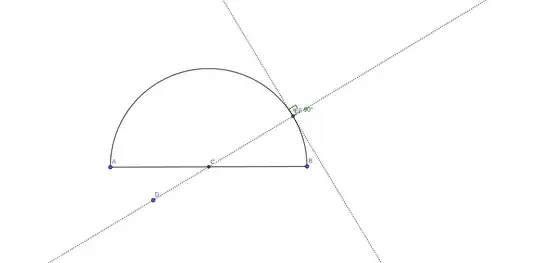

Hint: As shown in the figure, in plane geometry , the projection of a point on the circle is where the line connecting the point and center of the circle ,$l$,intersects the circle. In solid geometry it is the intersection of $l$ and sphere.You have to solve following system of equations:
$\begin{cases}x^2+y^2+z^2=r^2;( equation ,of, the, sphere).\\\frac{x-x_O}{x_c-x_O}=\frac{y-y_O}{y_c-y_O}=\frac{z-z_O}{z_c-z_O}=t(equation, of, the, line \end{cases}$
Where C is the point to be projected and O is the center of the sphere.
Find x, y and z in terms of $t$, then put these in the equation of the sphere, you will find an equation of degree 2 in terms of $t$. Solve this equation and find the value of $t$, put this in the equation of the line and find the coordinates of projection of C(or P) on the sphere.You can use this rule for both cases.
$\frac{x-x_O}{x_c-x_O}=t$
$\frac{y-y_O}{y_c-y_O}=t$
$\frac{z-z_O}{z_c-z_O}=t$
In your case we have:
$(x_O, y_O, z_O)=(0, 0, 1)$
$(x_C, y_C, z_C)=(0, 0, H)$
$(x_P, y_P, z_P)=(X, Y, Z)$
sirous
  • 12,694
    If my understanding of the figure you provide and the text of your answer is correct, you are projecting from the center of the sphere. However, in my case the line of projection does NOT pass through the center of the sphere. Am I misinterpreting your answer? – Lawton Dec 16 '23 at 13:33
  • Your understanding is correct. I cannot imagine the projection of a point on a circle or sphere is not through their centers. Do you know any reference to show that, maybe I am not aware of. thanks. – sirous Dec 16 '23 at 18:42
    That's what I'm asking for in my question. I included two pictures showing the setup. As I say, all I can find is information on how to project from the center of the sphere or from the pole of the sphere. However, I want to project from a point that is between the center and surface of the sphere, rather than at either extreme. – Lawton Dec 16 '23 at 19:05
  • makes no difference where the point is located. Due to the definition of projection, it is the foot or intersection of a line passing the point and perpendicular on a surface. Hence you must have the equation of the line anyway.For this you need the know the coordinates of at least two points. You just have this for one point P. – sirous Dec 16 '23 at 20:35
