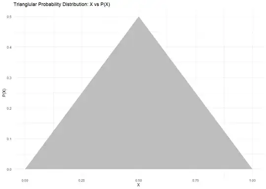

For example, suppose I want to make a Probability Distribution Function that looks like a triangle and has a peak at 0.5. This would look something like this:
library(ggplot2)
df <- data.frame(x = c(0, 0.5, 1, 0), y = c(0, 0.5, 0, 0))
ggplot(df, aes(x, y)) + geom_polygon(fill = "grey") + xlab("X") + ylab("P(X)") + ggtitle("Trianglular Probability Distribution: X vs P(X)") + theme_minimal()

    Your code and plot (slope $\pm 1$) don't match your formula (slope $\pm 2$). – aschepler Nov 14 '23 at 01:30
  • @ aschepler: thank you for pointing this out - I will revise this right now – stats_noob Nov 14 '23 at 01:31
  • You measure the grey area in your graph above (using classical geometry in this case, or an integral for more complicated distributions) and get $A = \frac 12 bh = \frac 14.$ Now you have some choices, make the peak higher, or the base wider, or some combination of both. – user317176 Nov 14 '23 at 01:32
    There is no problem having a piecewise density. You do the integration and then rescale, so your $2x$ on $[0,\frac12]$ and $2(1-x)$ on $(\frac12,1]$ integrates to $\int_0^{1/2}2x,dx+ \int_{1/2}^1 2(1-x),dx=\frac14+\frac14=\frac12$ so you have to double everything to reach an integral of $1$, giving a density for your triangular distribution of $4x$ on $[0,\frac12]$ and $4(1-x)$ on $(\frac12,1]$ and $0$ elsewhere. – Henry Nov 14 '23 at 01:38

Your function can be integrated using geometry (area under the curve). Using the standard formula for area of a triangle, it is $$\frac{1}{2}hb=\frac{1}{2}\times\frac{1}{2}\times1=\frac{1}{4}$$
Since you would like to make the area 1, you multiply the function by 4(reciprocal of 1/4).
In general, this is called the process of normalizing the function.
Note: I have used your graph, and not your piece wise function to answer. The two do not match. For example, 2x at 0.5 is 1, but the graph shows 0.5
