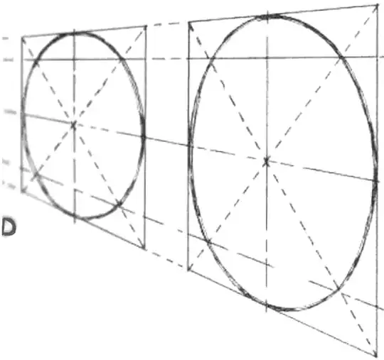

Edit: I clarify that I want to achieve the type of curves or arcs used in perspective to create circles. Next I leave a photo (it does not belong to me) to illustrate:

    The picture suggests that you want to draw an ellipse. Java can do that: https://chortle.ccsu.edu/java5/notes/chap36/ch36_5.html – Ethan Bolker Jul 31 '23 at 00:59
  • @EthanBolker Partly that's true, but I want to draw curves/arcs in general. Thanks the same! – Dante S. Jul 31 '23 at 13:06

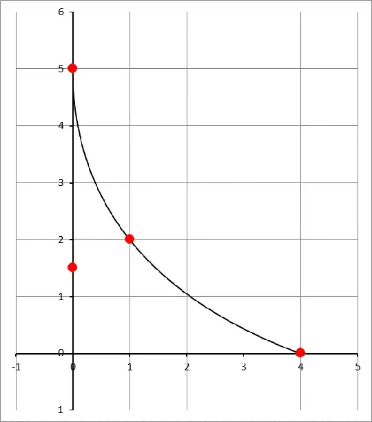

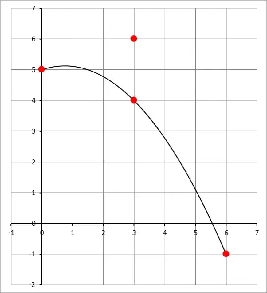

One way you can solve this problem is by using Bezier quadratic curves. The curve is given parametrically by
$ P(t) = P_1 (1 - t)^2 + 2 t (1 - t) P_2 + t^2 P_3 $
where $P_1$ is the starting point, $P_3$ is the end point, and $P_2$ is the point where the tangents to this (parabola) at $P_1$ and $P_3$ intersect.
You have $P_1$ and $P_3$ but you don't have $P_2$. Instead you have the midpoint of the curve at some $t \in [0, 1] $. Let's call this point $P_4$, so what you have is $P_1$ (start), $P_3$ (end) and $P_4$ (midpoint). What you don't have is $P_3$ and the value of $t = t_0$ at which $P(t_0) = P_4$.
Let your parameter be $t_0$, then
$ P(t_0) = P_1 (1 - t_0)^2 + 2 t_0 (1 - t_0) P_2 + t_0^2 P_3 = P_4 $
For example, we can take $t_0$ to be equal to $0.5$. Substituting this, we get
$ P_2 = \dfrac{ P_4 - P_1 (1 - t_0)^2 - t_0^2 P_3 }{2 t_0 (1 - t_0) } $
Since we've selected $t_0 = 0.5$ then
$ P_2 = \dfrac{ P_4 - 0.25 P_1 - 0.25 P_3}{0.5} = 2 P_4 - 0.5 P_1 - 0.5 P_3 $
Now that we have $P_2$, we can draw the curve $P(t)$ from $t = 0$ to $t = 1$.
Below are two examples of this method. The red points are $P_1$ through $P_4$ with $P_2$ being the calculated point and lies outside the curve while $P_4$ is the given midpoint.
