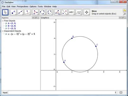

  4. Solve for the center as $$ (x_c,y_c) = (3,2) $$
  5. Plug the values for the center in any of the three quadratic equations above (I choose the first) and solve for $r$ $$ (1-3)^2+(1-2)^2-r^2 = 0 $$ $$ 5-r^2 = 0 $$ $$ r = \sqrt 5 $$
  6. Verify result with GeoGebra (optional)
ScreenShot

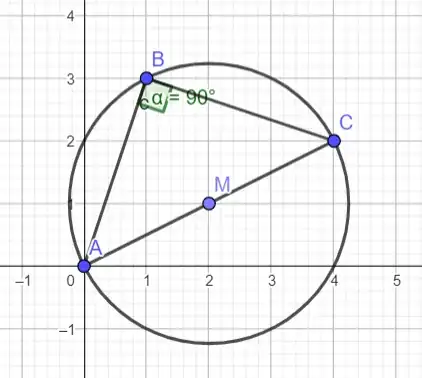

If $A = (1,1),$ $B = (2,4)$ and $C = (5,3),$ then - making $B$ the "origin", to see if it helps (I tried $A$ first, and would have tried $C$ next, if $B$ hadn't worked) - we have $A - B = (-1, -3)$ and $C - B = (3, - 1),$ whence $(A - B) \cdot (C - B) = -3 + 3 = 0,$ i.e., the angle at $B$ is a right angle, therefore $AC$ is a diameter, therefore the centre is $(A + C)/2 = (3, 2),$ and a radius vector is $(2, 1),$ therefore the square of the radius is $5,$ therefore the equation is $(x -3)^2 + (y - 2)^2 = 25.$
Presumably the values of $A, B, C$ were chosen to enable this simple solution.

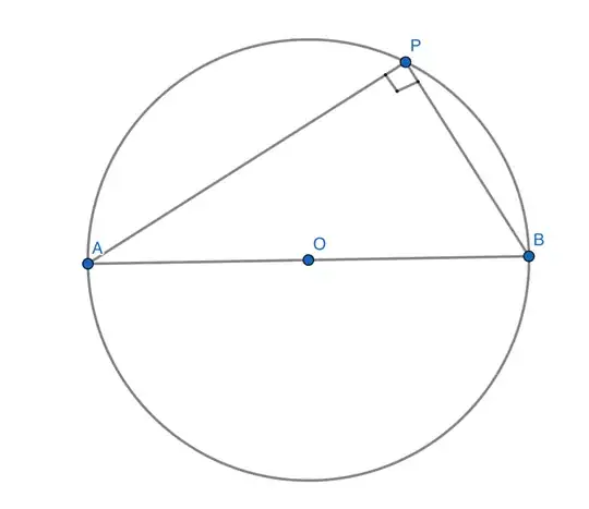

Just for the sake of adding an answer:
Take any two points of the given three :$A(x_1,y_1)$ and $B(x_2,y_2)$. We will first determine the circle $\Omega$ having $AB$ as the diameter. This may seem arbitrary, but I assure you it is not.
Let $P(x,y)$ be any point on the circle. Then, $\angle APB$ is an angle in a semicircle and is hence a right angle. By writing $m_{AP}\cdot m_{BP}=-1$, we have $$\left(\frac{y-y_1}{x-x_1}\right)\left(\frac{y-y_2}{x-x_2}\right)=-1$$$$\implies (y-y_1)(y-y_2)+(x-x_1)(x-x_2)=0$$ is the equation of $\Omega$. Now, the straight line, $L$, through $A$ and $B$ is $$\frac{y-y_1}{x-x_1}= \frac{y_2-y_1}{x_2-x_1}$$$$\implies (y-y_1)(x_2-x_1)-(x-x_1)(y_2-y_1)=0$$
Now we will write the equation of a family of circles passing through $A$ and $B$. This can be written as $$\Omega +\lambda L=0$$ and this can be verified to being a circle for all $\lambda$. Now you can understand why we found the equation of $\Omega$: to find a similar (to the required curve) but special curve passing through the points of interest.
Now, put $(x_3,y_3)$ in the equation and solve for $\lambda$. This will give the required equation of the circle.
  • Like in the solution by amd, you use a "pencil of conics". amd is with a linear combination of 2 conics. Whereas, in your proposal, the second conic isn't a conic but a line, But in such a case shouldn't the pencil be $\Omega+\lambda L^{\color{red}{2}}$ in order to have two second degree expressions (a doubled line is considered as a - degenerate - conic) ? – Jean Marie Feb 14 '24 at 02:51

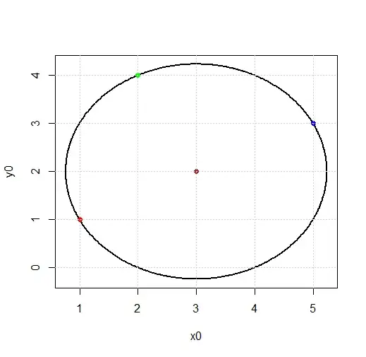

Equation of a circle with center $(x_0, y_0)$ and radius $r$ is
$$(x-x_0)^2+(y-y_0)^2=r^2$$
which can be expressed as
$$x^2+y^2+ax+by+c=0 \quad \quad \ldots (1)$$
where
$$\begin{array} xx_0 &=& -\frac{a}{2} \\ y_0 &=& -\frac{b}{2} \\ r &=& \sqrt{x_0^2 + y_0^2 - c} \quad \quad \ldots (2) \end{array}$$
Now, if the circle passes through points $(x_1,y_1)$, $(x_2,y_2)$ and $(x_3,y_3)$ (assuming that they are not collinear), then the equation $(1)$ is satisfied by the points, so that we have
$$\begin{array} aax_1 + by_1 + c &=& -x_1^2 -y_1^2 \\ ax_2 + by_2 + c &=& -x_2^2 -y_2^2 \\ ax_3 + by_3 + c &=& -x_3^2 -y_3^2 \end{array}$$
with solution
$$\begin{array} aa &=& \frac{det\left(\begin{bmatrix}-x_1^2-y_1^2 & y_1 & 1 \\ -x_2^2-y_2^2 & y_2 & 1 \\ -x_3^2-y_3^2 & y_3 & 1 \end{bmatrix}\right)}{det\left(\begin{bmatrix}x_1 & y_1 & 1 \\ x_2 & y_2 & 1 \\ x_3 & y_3 & 1 \end{bmatrix}\right)} \\ b &=& \frac{det\left(\begin{bmatrix}x_1 & -x_1^2-y_1^2 & 1 \\ x_2 & -x_2^2-y_2^2 & 1 \\ x_3 & -x_3^2-y_3^2 & 1 \end{bmatrix}\right)}{det\left(\begin{bmatrix}x_1 & y_1 & 1 \\ x_2 & y_2 & 1 \\ x_3 & y_3 & 1 \end{bmatrix}\right)} \\ c &=& \frac{det\left(\begin{bmatrix}x_1 & y_1 & -x_1^2-y_1^2 \\ x_2 & y_2 & -x_2^2-y_2^2 \\ x_3 & y_3 & -x_3^2-y_3^2 \end{bmatrix}\right)}{det\left(\begin{bmatrix}x_1 & y_1 & 1 \\ x_2 & y_2 & 1 \\ x_3 & y_3 & 1 \end{bmatrix}\right)} \end{array}$$
Now, from $(2)$, we can compute the center $(x_0,y_0)$ and radius $r$ of the circle.
We can implement the above with the following r function find.circle(), which accepts the arguments $(x_1,y_1)$, $(x_2,y_2)$ and $(x_3,y_3)$ corresponding to the coordinates of the $3$ points the circle passes through, and returns the center $(x_0,y_0)$ and radius $r$ of the circle:
find.circle <- function(x1, y1, x2, y2, x3, y3) {
A <- matrix(c(x1, x2, x3, y1, y2, y3, 1, 1, 1), ncol=3) b <- c(-x1^2-y1^2, -x2^2-y2^2, -x3^2-y3^2) res <- solve(A, b) a <- res[1] b <- res[2] c <- res[3] print(c(a,b,c)) x0 <- -a/2 y0 <- -b/2 r <- sqrt(x0^2 + y0^2 - c) return(c(x0,y0,r)) }
x1 <- 1 y1 <- 1 x2 <- 2 y2 <- 4 x3 <- 5 y3 <- 3
find.circle(x1, y1, x2, y2, x3, y3)
[1] -6 -4 8 # (a, b, c)
[1] 3.000000 2.000000 2.236068 # (x0, y0, r)
The equation of the circle is $x^2 + y^2 - 6x - 4y + 8 = 0$, i.e., $(x-3)^2+(y-2)^2=5$.
res <- find.circle(x1, y1, x2, y2, x3, y3)
x0 <- res[1] y0 <- res[2] r <- res[3]
plot(x0, y0, pch=19, xlim=c(x0-r,x0+r), ylim=c(y0-r,y0+r), col='brown') for (theta in seq(0,2pi,0.01)) { points(x0 + rcos(theta), y0 + r*sin(theta), pch=19, cex=0.3) } points(x1, y1, pch=19, xlim=c(x0-r,x0+r), ylim=c(y0-r,y0+r), col='red') points(x2, y2, pch=19, xlim=c(x0-r,x0+r), ylim=c(y0-r,y0+r), col='green') points(x3, y3, pch=19, xlim=c(x0-r,x0+r), ylim=c(y0-r,y0+r), col='blue') grid()
Sandipan Dey
  • 2,249
  • This is a nice answer because it can be used to fit a circle to more than three points, or it can be used to find a conic section when given five points. – John Alexiou Mar 06 '25 at 19:51
All answers to this question are all general ones, but I would start by translating those points until one of them equals $(0,0)$. When doing this the easiest way, the other points become $(1,3)$ and $(4,2)$.
It's easy to see that the squares of the distances between the points are:$1^2+3^2$ (being $10$), again $1^2+3^2$ and $4^2+2^2$ (being $20$).
Wait a minute: when sum of the squares of a triangle equals the square of the other side, then you have a rectangular triangle, meaning that the hypothenusa equals the diameter of the circle and the middle point of the diameter is the centre of the circle.
(The whole length-based reasoning does not need the translation of one point to $(0,0)$, but this is a "standard" way to deal with analytical geometry issues.)
Screenshot:
Geogebra screenshot
Dominique
