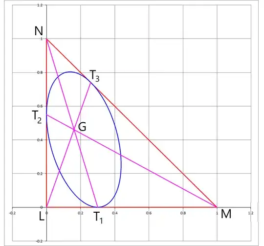

I will first numerically/graphically verify the statement to be proved. Given $\triangle ABC$, it can be transformed into an isosceles right triangle, with vertices $L(0,0), M(1,0), N(0, 1)$ using the affine transformation $\mathbf{y} = \mathbf{A x + b}$, for some matrix $\mathbf{A}$ and some vector $\mathbf{b}$.
Clearly, an inscribed ellipse of the original triangle is transformed into an inscribed ellipse of the transformed triangle, and the line segments connecting the vertices to the touching points of the inscribed ellipse in the original triangle will be transformed into line segments in the transformed triangle. So if this set of the three line segments is concurrent, then so will be the set of the corresponding three line segments in the transformed triangle and ellipse, and vice versa.
From this, it is sufficient to show that the line segments connecting the vertices of the transformed triangle to the touching points of the transformed ellipse are concurrent, to show that they are concurrent in the original triangle.
Now suppose we are given the relative location of the touching points of the ellipse on sides $AB$ and $AC$, then these are transformed into known points $T_1$ and $T_2$ on $LM$ and $LN$ respectively, because the relative location of points on line segments does not change after an affine transformation, as defined above. The location of the touching point $T_3$ on side $MN$ is not arbitrary and can be found analytically.
Now we have three touching points, and three vertices, so we just connect them in pairs and see if they intersect at the same point. This is what I have done, and the figure below illustrates this. Thus I have verified that the line segments connecting vertices to the touching points of an in-ellipse on the opposite sides do indeed intersect in a single point.

Now the intersection of $NT_1$ and $MT_2$ is easily shown to be
$ G = \dfrac{1}{1 - t_1 t_2} (t_1 ( 1- t_2), t_2 (1 - t_1) ) $
Clearly, point $G$ lies on $LT_3$. And this concludes the proof.

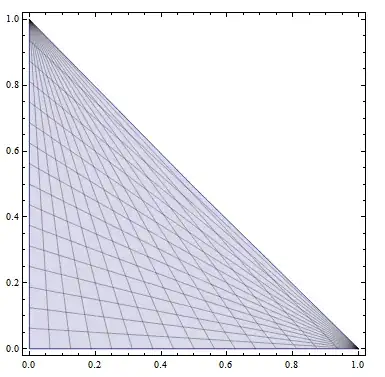

  • By the way, what would that be the locus of the concurrent point of variable touching ellipses? Or would that be a separate question? – Narasimham Jun 14 '22 at 10:44
  • Yes. That's very interesting –  Jun 14 '22 at 11:20
  • @Narasimham If the touching point with the horizontal side is $ (t_1,0)$ and the touching point with the vertical side is $(0,t_2)$, then the concurrent point is $(\dfrac{t_1(1-t_2)}{1-t_1t_2},\dfrac{t_2(1-t_1)}{1-t_1t_2})$ –  Jun 14 '22 at 13:10
  • I included the loci , to me counter-intuitive at the outset... – Narasimham Jun 14 '22 at 17:43

$$(x_c,y_c)=\left(\frac{t_1- t_1t_2}{1-t_1t_2},\frac{t_2-t_1 t_2}{1-t_1t_2}\right)$$ enter image description here
