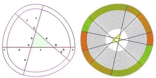

I have been working on this type of curves. Here are three examples of them in pictures:
Fig. 1: Wheels. The LHS "wheel" is build out a general triangle with sidelengths $a,b,c$. Sidelength $a$ is extended by 2 line segments: one having length $c$, the other one having length $b$, in order that the total length of the extended side is $a+b+c$. This operation is done twice again. Whatever the direction, the apparent diameter is always $a+b+c$. The RHS figure, instead of a triangle, is based on a (starshaped) pentagon. See here.

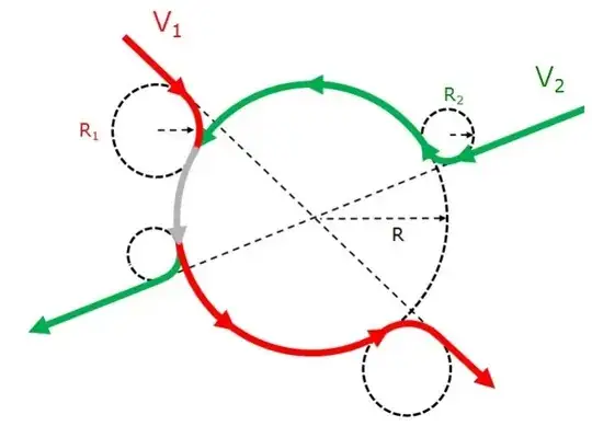

Fig. 3: "Avoiding curves" for two aircrafts in red and green arriving from NW and NE resp. with a colliding risk if their trajectories aren't changed. The air control regulation will schedule for them a "roundabout routing" in order to avoid this collision risk. Here the "green" aircraft will take a longer path in order to let the "red" aircraft pass before it.
Remark: I didn't knew Dubins paths. Thank you.
