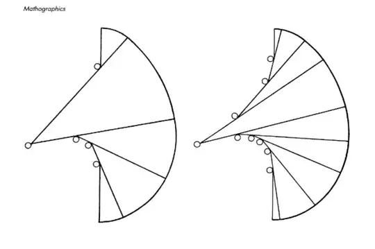

In Mathographics Robert Dixon shows how to draw an Egg-curve (or really half of an egg curve) as an involute:
This allows you to draw a smoother version of eggs created from the 'arcs of a circle method.'
I want to know the formula for idealized involute curves of this type (i.e., 0-D pins, and 0 width string, etc....):
What is the formula for parametric equations for points, $(x_1, y_1), (x_2, y_2), (x_3, y_3)..., (x_n, y_n)$, given a starting point $(x_f, y_f)$ and a point $(x_O, y_O)$ where the string is attached?

    @Moo Thank you. I've read that paper. So far as I can tell, it gives good instructions for the geometric constructions made with circle arcs (which I view as approximations of the involute, like a 'spiral' made from circle arcs can approximate a logarithmic spiral).
    What I'm looking for are the parametric equations of the 'string, pins, and pen' involute given by Dixon (see image attached in post).

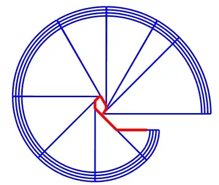

Have a look at Fig. 1 modelizing the position of the extremity of a string rolled/unrolled along a convex polygon (here the particular case of a regular octagon) generating a kind of spiral (modelizing rather well a half-egg-shape) ?
Fig. 1.
But one can obtain much general type of curves as one can see on Fig. 2 (see Matlab program below). Here, four different curves ("offsets" of the first one) are displayed just by changing the curve length.
Fig. 2.

Matlab program (using complex numbers geometry) having generated figure 2 :
 function main;
    a=80;axis([-a,a,-a,a])
    A=[0,pi/4,pi/3,pi/2,2*pi/3,pi,5*pi/4,3*pi/2,7*pi/4,2*pi];% sides polar angles
    Lg=[1,1,3,2,7,1,4,5,20,20];% side lengths
    V=Lg.*exp(A*i);A=[A,A(1)];Lg=[Lg,Lg(1)];L=sum(Lg);
    LA=length(A);
    Pt=cumsum(V);% points, obtained by cumulating vectors
    for k=0:2:6
       C=[]; % curve
       M=L+k;
       for k=1:LA-2
          T=cs(Pt(k),M,A(k),A(k+1));
          C=[C,NaN,T];
          M=M-Lg(k+1);
       end;
       plot(C,'b','linewidth',2);hold on;
    end;
    plot(Pt,'color','r','linewidth',4);hold on
 function T=cs(ce,r,t1,t2);% circular sector
    s=sign(t2-t1);
    T=ce+r*[0,exp(i*(t1:s*0.005:t2)),0];
