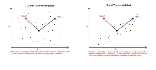

I found this link useful for understanding what Mahalanobis distance measures actually. The following image captures the essence very well: Uncorrelated vs. Correlated data in 2D
If your dataset has a strong correlation as in the plot on the right, you probably want Point 2 to be more distant to black point in the center than the Point 1, although they have the same Euclidean distance. As Avitus pointed out, multiplying with the inverse of the correlation matrix deforms the Eucledean distance so that Point 2 becomes more distant than Point 1.
