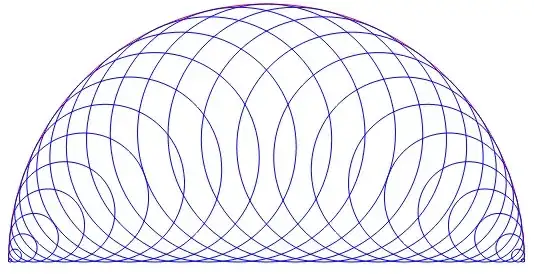

Let us now consider the family $(F)$ of circles inscribed into this semicircle as can be seen on Fig. 1.
Fig. 1: Certain circles of family $(F).$

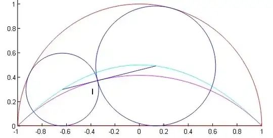

Each circle $(C_T) \in F$ is associated with a unique circle $(C_{T'}) \in F$ which is tangent to $(C)$ as depicted on Fig. 2.
Fig. 2: Two circles of family $(F)$ are mutually tangent if their parameters $T$ and $T'$ comply with relationship (4).
Let $I$ be the point of tangency of $(C_T)$ and $(C_{T'})$.
Question: how can we describe the locus of $I$?
(sketched as the magenta curve on Fig. 2.)

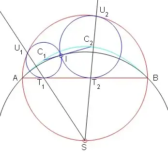

Edit: Nice solution using inversion (a little different from the solution given in a comment by Blue).
'Refer to Fig. 3). Consider inversion with pole $S(0,-1)$ and power $2$ meaning that $M$ is exchanged with $M'$ iff $S,M,M'$ are aligned and $SM.SM'=2$. Its circle of inversion is the black circle (center $S$, radius $\sqrt{2}$). It is easy to see that any circle of family (F) is globally invariant. This is in particular the case for the two blue circles. As the image by inversion of two tangent curves in a certain point $I$ is two tangent curves with contact point $I'$ where $M'$ is the image of $M$, point $I$ is invariant, establishing that $I$ belongs to the circle of inversion.$\square$
As a consequence, tangency points $T_1$ and $U_1$, $T_2$ and $U_2$, are exchanged, meaning that $S,T_1,U_1$ and $S,T_2,U_2$ are aligned.
Fig. 3.

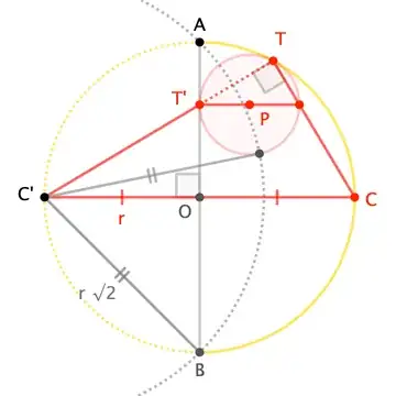

There's something more fundamental going on here.
Consider any circle $\bigcirc P$ tangent to the semicircle $ACB$ at $T$ and the diameter at $T'$. (My figure is rotated.) Let $\overline{CC'}$ be the perpendicular diameter with $C$ the midpoint of the semicircle.
Thales' Theorem guarantees that right angle $\angle CTC'$ subtends parallel diameters of $\bigcirc P$ and $\bigcirc O$; thus, $C'$, $T$, $T'$ are collinear, and $\triangle CTC'\sim\triangle T'OC'$, so that $$|C'T||C'T'|=|C'C||C'O|=2r^2$$ That is, the power of $C'$ with respect to $\bigcirc P$ is independent of $P$. Consequently,
  • the tangent segments from $C'$ to any circle is $\sqrt{2r^2}=r\sqrt{2}$; and
  • $C'$ lies on the radical axis of any pair of circles.
In the specific case of a pair of inscribed circles that are tangent to each other at a point $I$, the mutual tangent line through $I$ is their radical axis, necessarily meeting $C'$. Moreover, $\overline{C'I}$, being a tangent segment to each circle, has length $r \sqrt{2}$. We conclude that $I$ lies on the circle of radius $r\sqrt{2}$ about $C'$. $\square$

  • Once again, you pinpoint the "root ideas". I think that a proof using inversion should exist as well. – Jean Marie Mar 13 '21 at 10:01
    @JeanMarie: I try. :) ... Incidentally, if you carry the construction beyond the bounds of the semicircle ---ie, taking the centers anywhere along the parabola, and maintaining tangency with the diameter-line--- then the inscribed circles of the semicircle become exscribed circles of the other semicircle, and the locus of $I$ becomes the (almost-) entire circle about $C'$. – Blue Mar 13 '21 at 10:09
    @JeanMarie: "I think that a proof using inversion should exist as well." ... Indeed: One can argue without specificity that there's some circle through $A$ & $B$ such that inversion exchanges $\overline{AB}$ w/ $\stackrel{\frown}{ACB}$. The inversion preserves tangencies and thus also the family of inscribed circles, and we conclude that the center of inversion ---wherever it may be--- has the requisite radical axis and tangent segment properties for the circle to be the locus of $I$. ... In fact, this argument works even for non-semicircle arcs and non-diameter chords ... and even two arcs! – Blue Mar 13 '21 at 12:30
