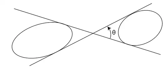

I have been trying to find the angle made by inner tangents to two general ellipse by following the method described by Futurologist to find four homogeneous equations of tangents, this method is presented here and uses the concept of dual conics and degenerate conics. Using that method, I am able to get four tangent equations in homogeneous coordinates. However, I am looking to find the angle between the inner common tangents. For that purpose, currently, I am solving for the intersection of the four tangent lines with the ellipse and then tracing those points back to get the angle made by inner common tangents. This process is a bit computationally expensive and I am looking for a less expensive algorithm.
My question here is that if it is possible to obtain that angle directly instead of going through the hassle of finding the intersection points? I am not interested in getting the equation of tangents. I just need the angle between them.
Graphically in the diagram below, that angle can be represented as $\theta$:
Note: Using the slopes of the lines obtained from above method do not return correct answer because we do not know if that angle is greater one or smaller one (two angle made by exterior or interior to those line), it depends on the relative position of the two conics. I want a generalize solution which will work for every configuration of two given conics anywhere in the 2D space.
  • Can you specify what is the way of defining the conics? Are they given in the form of two quadratic equations of two variables, or as position of center, angle between major axis and a coordinate axis and magnitudes of major and minor axes of each conic? Or maybe some other way? Are the conics always ellipses or circles? If not, then what is considered internal common tangents when you have hyperbolas and parabolas involved? – Futurologist Feb 14 '21 at 19:12
  • @Futurologist, the conics are given in the same form as in the previous thread I referred. I wanted to get the angle between internal common tangents between any two general conics but if you think it is not as clear for hyperbolas and parabolas, for now, let's consider conics are always ellipse as in the previous thread. – Kashish Dhal Feb 14 '21 at 23:28
  • @Futurologist, I have updated my question with a link to definition of general ellipse given in the quadratic form. – Kashish Dhal Feb 15 '21 at 00:58
Preliminaries (algorithm for solving a pair of quadratic equations of two variables):
It boils down to finding an algorithm for solving a system of two quadratic equations of two variables, by interpreting it as a projective geometry pencil of conics, then finding the three degenerate conics of the pencil together with a projective transformation that simplifies these three degenerate conics to the point of your being able to read off the solutions very easily in new simplifying coordinate system, and after that transforming them back to the original coordinate system.
I sketched an algorithm in python, I think it seems to work on your example... but I was in a hurry and did not check it properly, so there may be bugs...

Algorithm for calculating the angle between the internal tangents:

if the two conics are ellipses, they do not intersect the line at infinity.
by polarity, the poles of the line at infinity are
the (affine and in fact metric) centers of the ellipses and are located
inside the ellipses each. We use them to detect the inner tangents and
to orient the vectors normal to these tangents in a way
so that the angle between these two normal vectors is the vector on the picture
def dual_to_infinity_line(conic): p = dual_conic(conic).dot(np.array([0,0,1])) return homogenize( p[0:2] / p[2] )

''' Example of finding the angle between the common tangents of a pair of conics: conic 1: major axis = 2, minor axis = 1, angle = 45, center = (0,0) conic 2: major axis = 3, minor axis = 1, angle = 120, center = (15,0) '''
a = 2 b = 1 cntr = np.array([0,0]) w = 45
Eq1 = equation_from_conic(Conic(a, b, w, cntr)) Co1 = conic_from_equation(Eq1)
a = 3 b = 1 cntr = np.array([15,0]) w = 120
Eq2 = equation_from_conic(Conic(a, b, w, cntr)) Co2 = conic_from_equation(Eq2)
four_tngs = find_common_tangents(Co1, Co2)
inner_tngs = find_common_inner_tangents(Co1, Co2)
print( angle_bn_inner_tangents_of(Eq1, Eq2) )
Calculating the angle bisector line of the inner tangents.
Here is a routine that, given a pair of lines line1 and line2, represented by vectors with three coefficients, calculates the three coefficients of the angle bisector line that splits the angle in half. It also returns the slope of the tangent line, as the ratio of the y-increase divided by the x-increase.
def angle_bisector(line1, line2):
    n1 = line1[0:2]
    n2 = line2[0:2]
    n1 = n1 / math.sqrt(n1.dot(n1))
    n2 = n2 / math.sqrt(n2.dot(n2))
    n_bsec = n1 + n2
    p12 = np.cross(line1, line2)
    p12 = p12[0:2] / p12[2]
    c_bsec = n_bsec.dot(p12)
    return np.array([n_bsec[0], n_bsec[1], c_bsec]), np.array([-n_bsec[1], n_bsec[0]])
def angle_and_bsec_vector_bn_inner_tangents_of(eq_of_conic1, eq_of_conic2): c1 = conic_from_equation(eq_of_conic1) c2 = conic_from_equation(eq_of_conic2) tn = find_common_inner_tangents(c1, c2) if abs(np.all(tn.imag)) < 1e-10: tn = tn.real p1 = dual_to_infinity_line(c1)[0:2] p2 = dual_to_infinity_line(c2)[0:2] bsec, v_bsec = angle_bisector(tn[0], tn[1]) angle = angle_bn_C_lines(tn[0,:], tn[1,:]) if abs(angle.imag) < 1e-10: angle = angle.real if v_bsec.dot(p2 - p1) < 0: v_bsec = - v_bsec return angle, v_bsec / np.linalg.norm(v_bsec)
Futurologist
  • 9,659
  • Comments are not for extended discussion; this conversation has been moved to chat. – Xander Henderson Aug 15 '21 at 14:58
  • Hello @Futurologist, is it also possible to get the equation and slope of angular bisector line which bisects the two inner common tangents? When I try to calculate the slope of that line using equations of inner common tangents we obtained then sometimes it differs by 180 degrees. Do you think I should post a new question for that? I just need it for the real case not the imaginary one. – Kashish Dhal Oct 19 '21 at 22:20
    Hello @KashishDhal I added a function at the end of the post. I hope it is what you are looking for. And maybe you should include me as a collaborator to your project. – Futurologist Oct 20 '21 at 03:31
  • Hello @Futurologist, sure we can add you as a collaborator in our next research paper. I will ask for your details prior to sending next paper. Also, I think you should have minus sign in the n_bsec[0]/n_bsec[1] term to get the slope. However, irrespective of that, I do not get correct slope all the time. Sometime the slope is shifted by angle of 180 degrees. Also, I found another thread here: https://math.stackexchange.com/a/3216295/861640 , can we use the center of the ellipse to detect the correct sector in which the angular bisector would be located? I tried but that didn't work. – Kashish Dhal Oct 20 '21 at 04:58
  • @KashishDhal I do not understand the issue you are having. A line rotated 180 degrees is the same line. Consequently the slope should be the same after 180 degree rotation. The previous code already makes sure that the normal vectors of the two inner tangent lines are oriented so that the angle between them is equal to the angle between the inner tangents measured in the sectors containing the ellipses. Hence, the angle bisector's normal points in the sectors complementary to the sectors where the ellipses are. Consequently, the bisector should be in the sectors where the ellipses are. – Futurologist Oct 20 '21 at 15:01
  • Yes, you are correct but I am trying to get the orientation of vector along angular bisector line measured from Ellipse 1 to Ellipse 2. For my case, the angle should always be measured wrt to Ellipse 1. So a 180 degree rotation will not be correct because that would mean that the angle is measured from Ellipse 2 to Ellipse 1. – Kashish Dhal Oct 20 '21 at 15:15
  • The way I am doing this currently is I find the intersection points of the tangent lines with ellipse 1 and ellipse 2. After that I find the orientation of line 1 and line 2, making sure those lines pass from Ellipse 1 to Ellipse 2. Then I find the average of two angles to get the desired orientation of bisector line. This way I always get the correct result. However, I was thinking there would be a better way to do this, so asked this question. If you think what I am doing is also OK then please let me know. – Kashish Dhal Oct 20 '21 at 15:25
  • @KashishDhal I added a new version at the end of the post. Try it. – Futurologist Oct 21 '21 at 02:21
  • Thank you, I am traveling this week, I will implement it when I am back and update you about the results! Thank you for the help! – Kashish Dhal Oct 22 '21 at 03:32
  • Hello @Futurologist, I tried it for a few test cases and it produces the correct desired angle. However, the only recommendation is that we should return atan2(v_bsec[1],v_bsec[0]) instead of vector so the output is the desired angle. Thanks for the help! – Kashish Dhal Oct 29 '21 at 17:52
  • Thanks gain for this amazing solution @Futurologist. Not sure to fully understand the concept of projectivity, but my question is simple: how do I get the equation of the four tangents in the cartesian referenciel of the 2 initial ellipsis? – MohG Oct 17 '23 at 16:41
